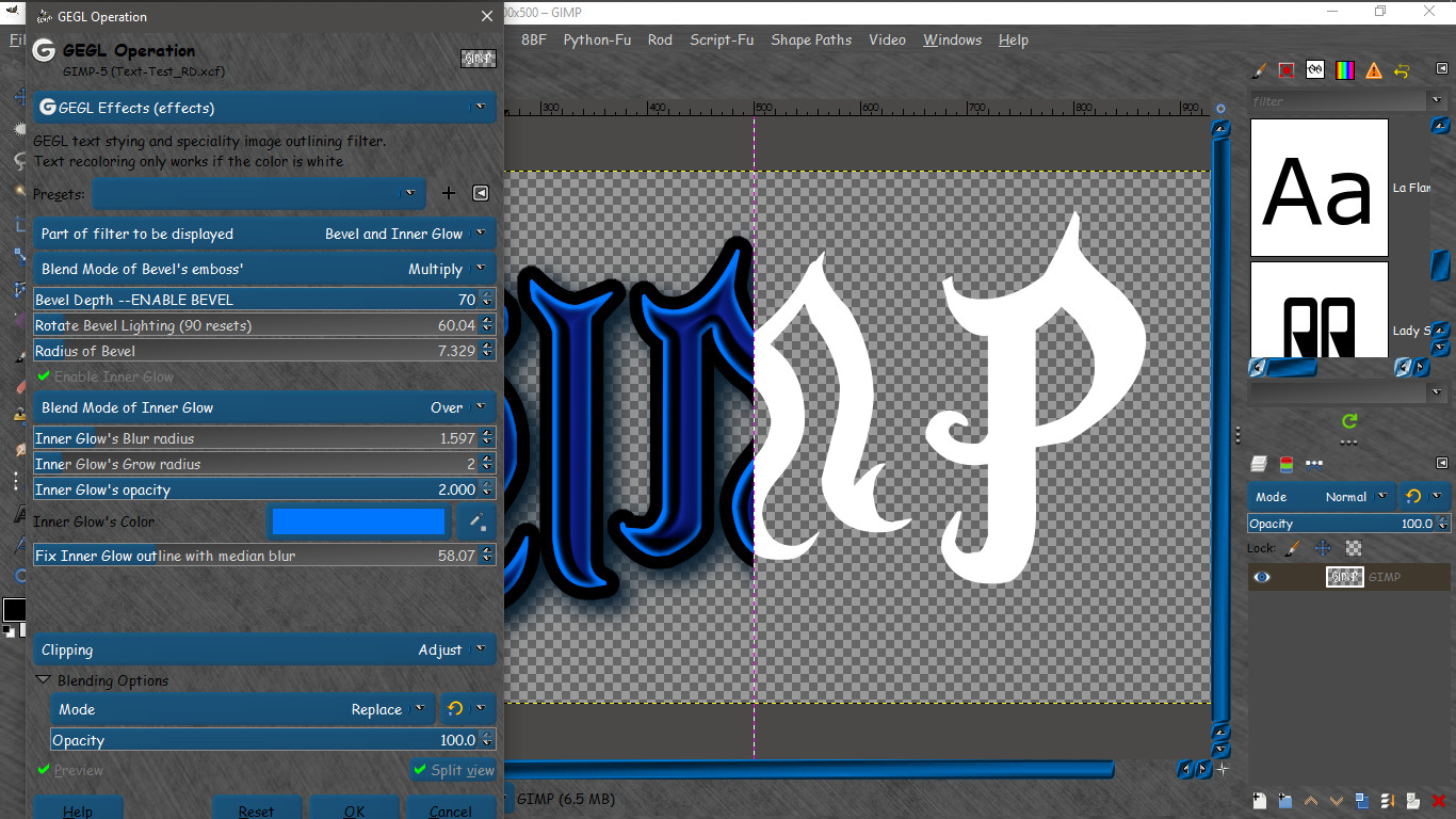

No more errors after re-running gegl effects. :) :bigthup

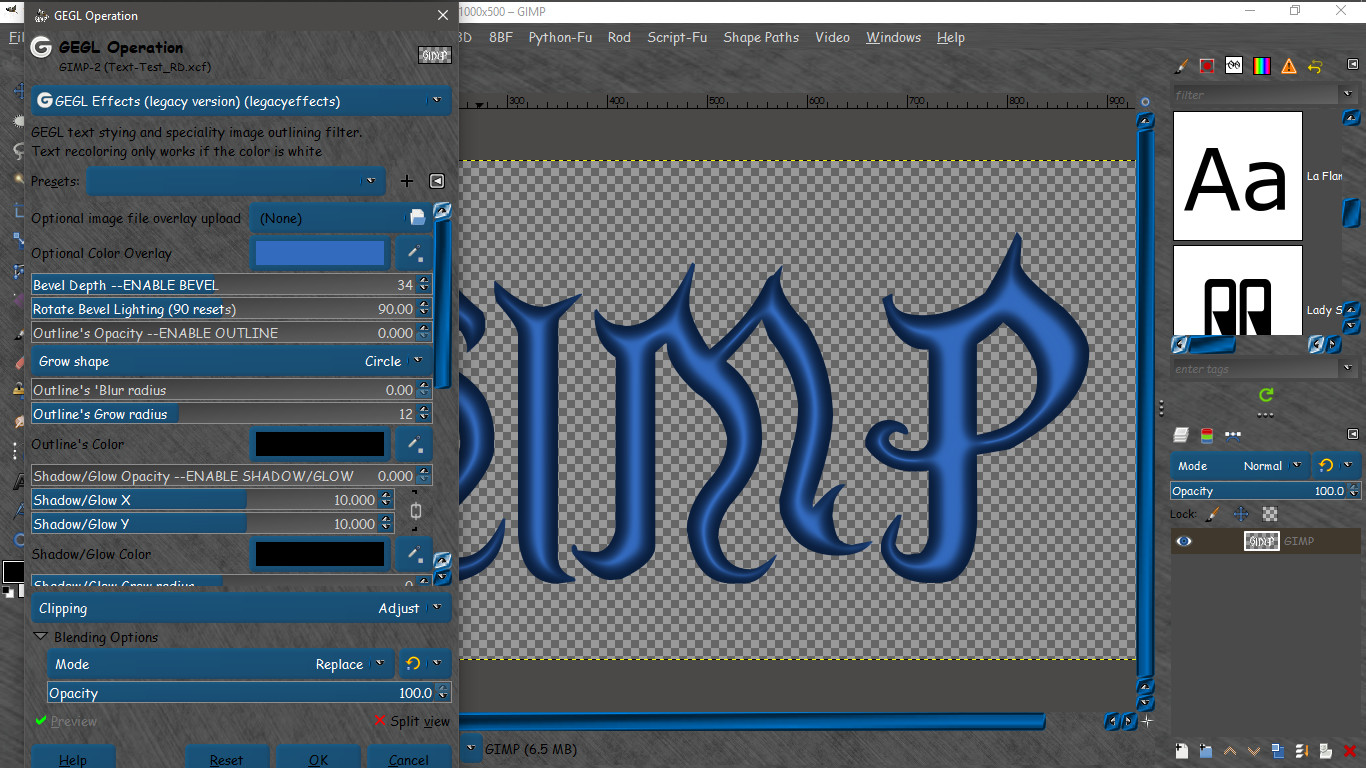

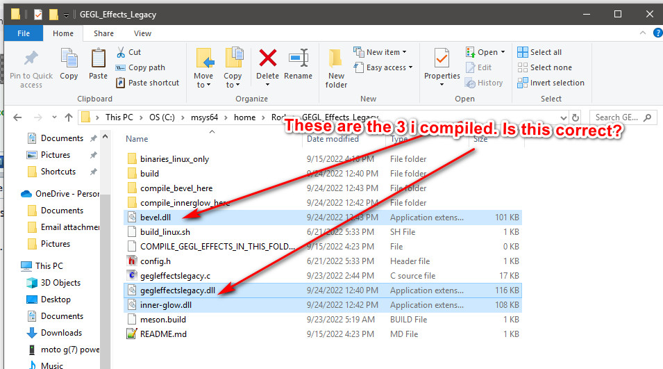

Wasn't sure what to compile here so i only compiled the legacy folder.
I removed the bevel.dll, inner-glow.dll, and the gegleffcts.dll and replaced them with these three.
Seems to be working ok. :bigthup :yes :hi5
No crashes on Windows.

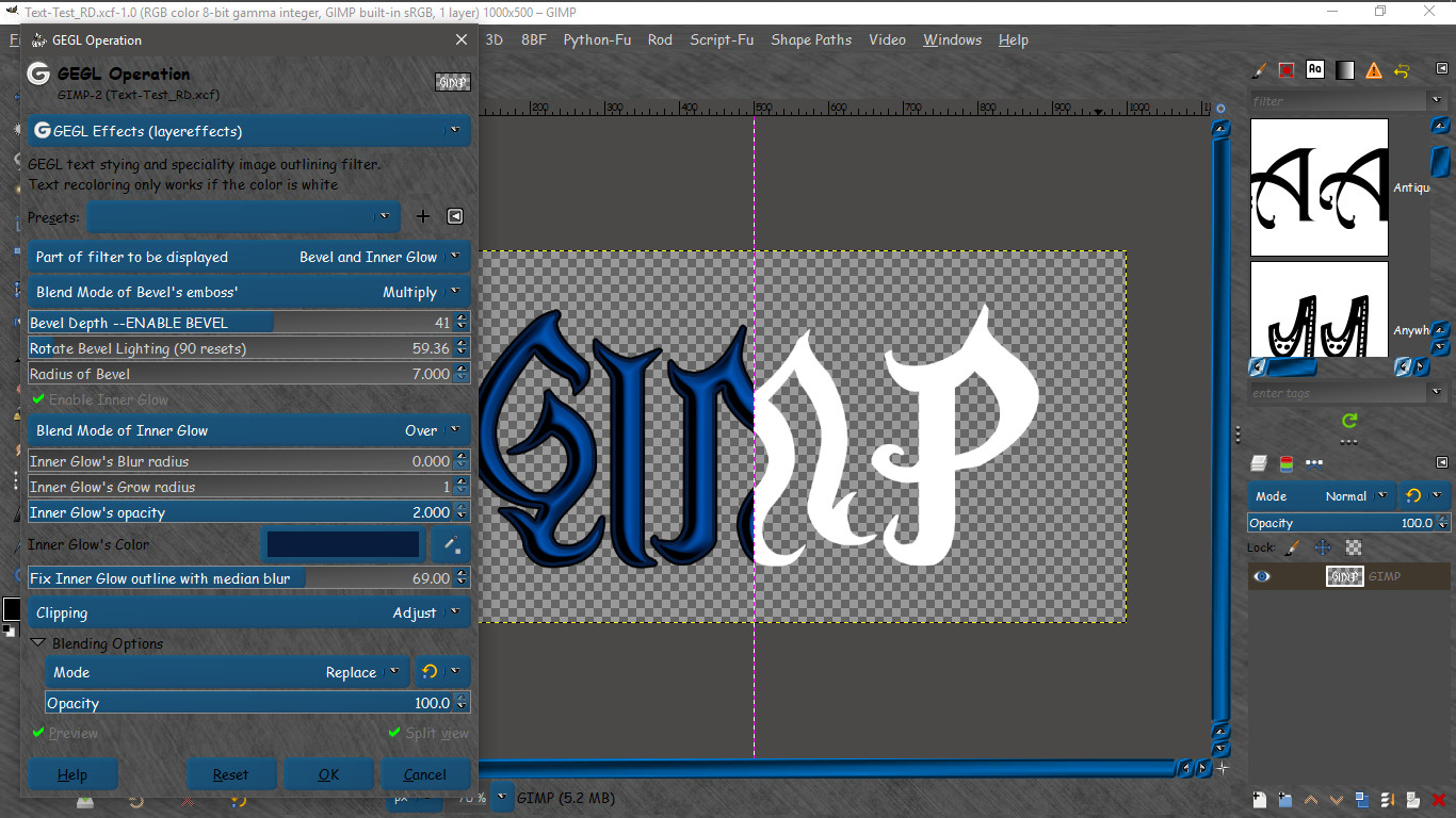

Thank you for the update contrast. :bigthup
