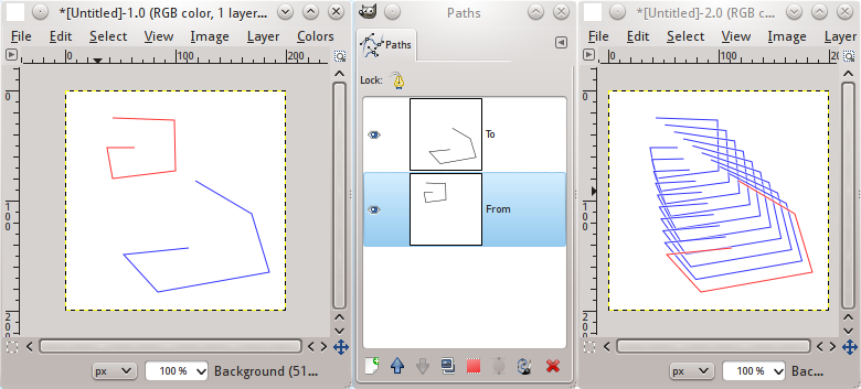

PostPosted: Tue Nov 04, 2014 8:44 am  (#106)
I made a third path with the curve but I don't know how to tie that in with the to and from.
FILL
STROKE

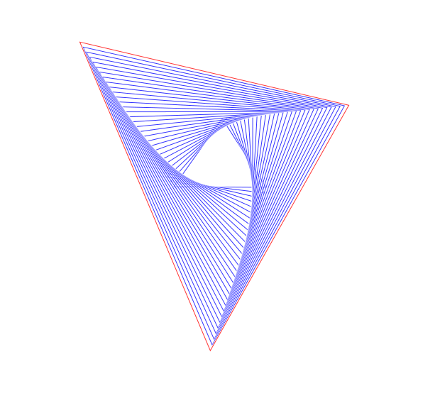

I've used your script to create flat design drop shadows*. I wrote down some notes back then but had forgotten to ask you. So here they are
The script doesn't blend paths using the nearest anchor points
but according to the paths start and end points?
That's what I'm getting with two 3angles: before and after rotating big 3angle 90 degrees clockwise.
Had to cheat to blend these two paths ;)
*Now look at the comment #30 in that thread and you being all skeptical about inbetweener script capabilities, lol

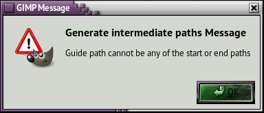

Thanks I got it now. I will have to change my Theme. I couldn't see the yes and no option, it was too dark ... my fault.
This is the error I get when I try it. I guess I don't know how to make a stroke path. I made an arc then stroked it then I tried to run the generator with the yes clicked and I get this error. Image
 Post subject: Re: path-inbetweener
PostPosted: Tue Nov 04, 2014 10:02 am  (#113)
This is the error I get when I try it. I guess I don't know how to make a stroke path. I made an arc then stroked it then I tried to run the generator with the yes clicked and I get this error. [ Image ]
You need three distinct paths. The start, the end, and the guide. You are using on the the start/end path also as the guide path.

K1TesseraEna wrote:
[font=Tahoma]I've used your script to create flat design drop shadows*. I wrote down some notes back then but had forgotten to ask you. So here they are
Yes, it's the order of the points that counts(*). Using the closest point when you twist the path over itself would yield unpredictable results. It would also break the assumption that you get the same results if you take the end paths and one of the intermediate paths and run the script on both sides.
For polygons, it's easy to force the first/last points. Just delete any segment between two points, and reconnect again. The new start and end points are the two points you reconnected. Of course you don't now in which direction the polygon runs, but I have a script to reverse strokes. For curve paths a similar technique is possible but requires a bit more care to preserve the tangents.

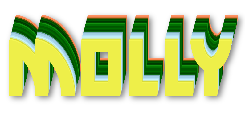

To Stroke all paths I can merge visible paths and stroke but
how can I stroke all paths at once with each path-stroke on separate layers (e.g. for animation)?
PostPosted: Tue Nov 04, 2014 10:48 am  (#116)
This is what my stroke-visible-paths script is all about (with the "multiple" layer option).

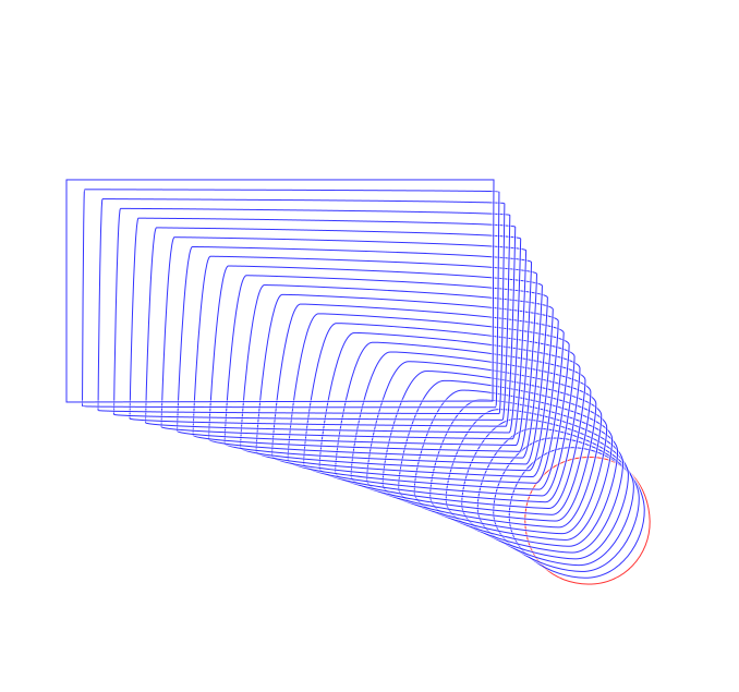

Playing with the "stretch" settings
these are the 2 original paths
