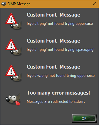

Version 5 works, Tran; just get this error console. :)
If you look at the errors it's just telling you what's undefined and what it's looking for so that you can define them if you want until no errors occur of have a flawless .xcf font (or you can just use what's generated) and ignore the errors.
