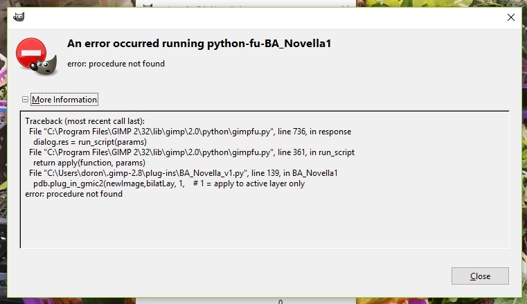

Hi Gimp users
I get the next error when i am running the Novella Filter.
So i need your help
Thanks.

doronf2 wrote:
Hi Gimp users
So i need your help
Thanks.
Are you using G'MIC 2.0?

Sallyanne, there was an error in preset 5, it is fixed in the new version (on page 1 of this topic ver 1a ). I don't know about a reset to default button Do you know of a python script with that feature? (maybe I could add one).
DoronF2 - you must select your G'mic version (1.7.9 or 2.0.0) before running the filter.
I put a reminder on the menu in version 1.a
