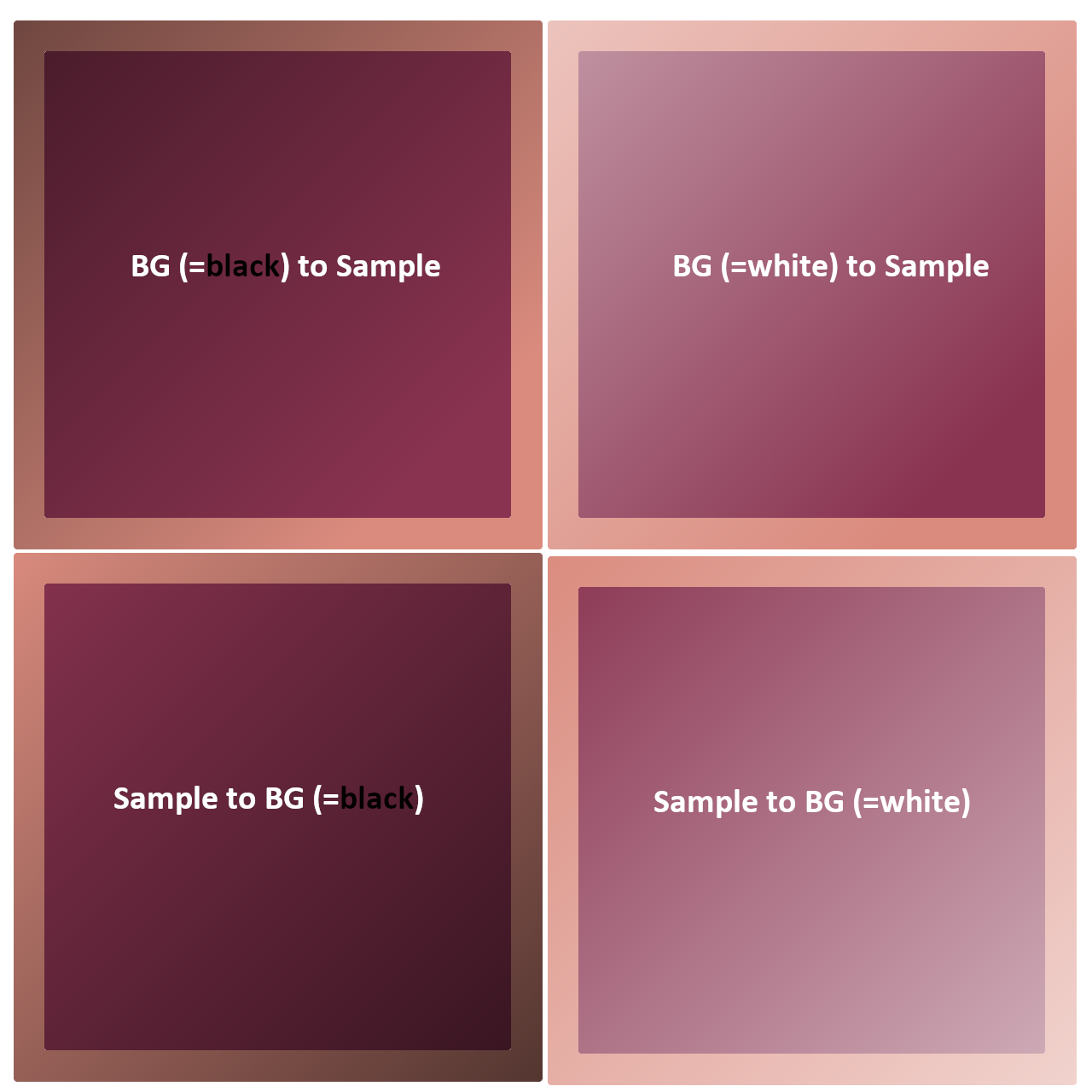

 Post subject: Re: Sample Color Border Plug-in
PostPosted: Thu Mar 14, 2019 3:26 pm  (#24)
Rel 1.8

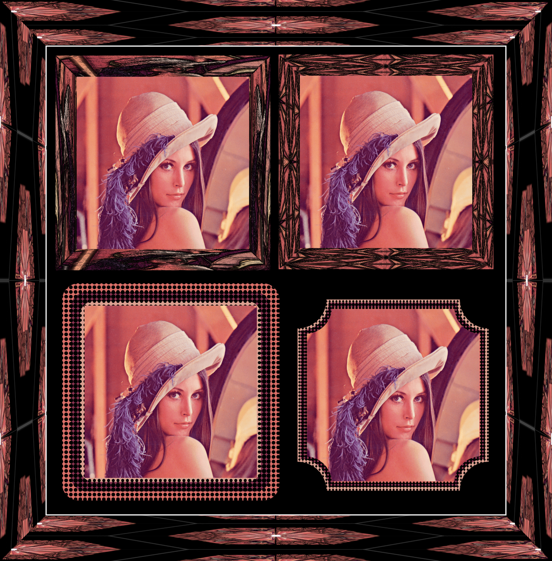

- add type: "Perspective Kaleidoscope" based on the kaleidoscope_ish.py plugin by Tin Tran: https://www.gimplearn.net/viewtopic.php?f=3&t=1415
- add efect type: "Emboss", "Newsprint" (DOTS, LINES, DIAMONDS, EUCLIDIAN-DOT, PS-DIAMONDS).

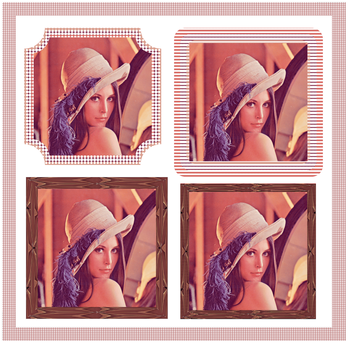

sample_color_border v.1.8.zip [5.76 KiB]
Downloaded 131 times

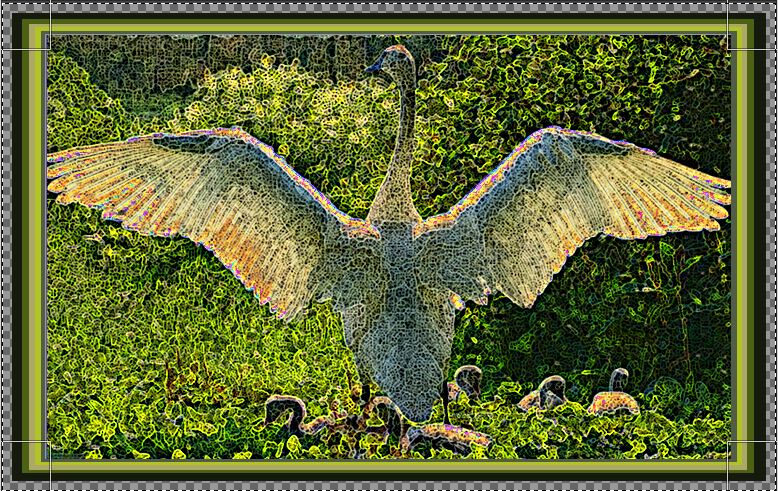

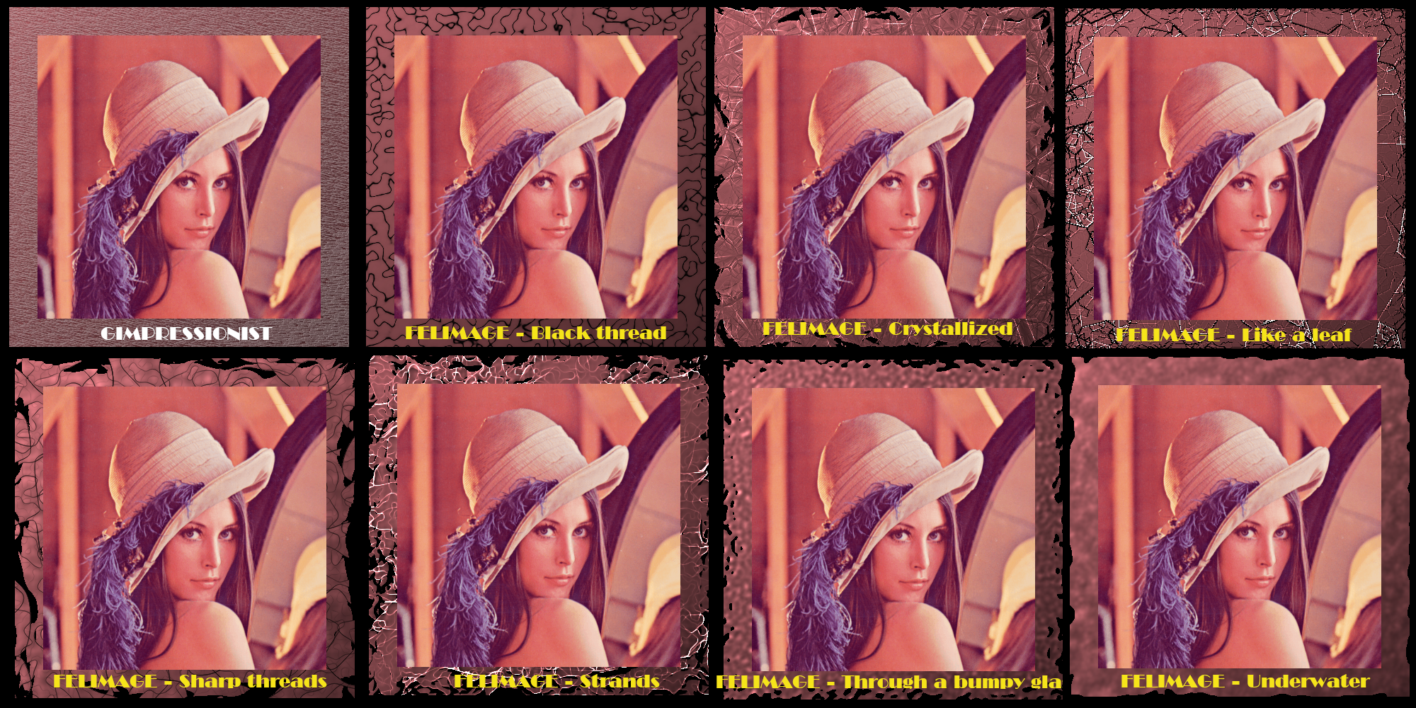

PostPosted: Sun Mar 17, 2019 10:40 am  (#25)
Rel 1.9 (final version)
- add option: "Blend gradient effect(using the background color)".
- add efect: Gimpressionist (interactive), FELIMAGE (non_interactive) Preset file: "Black thread", "Crystallized", "Like a leaf", "Sharp threads", "Strands", "Through a bumpy glass", "Underwater".

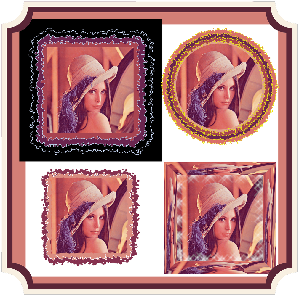

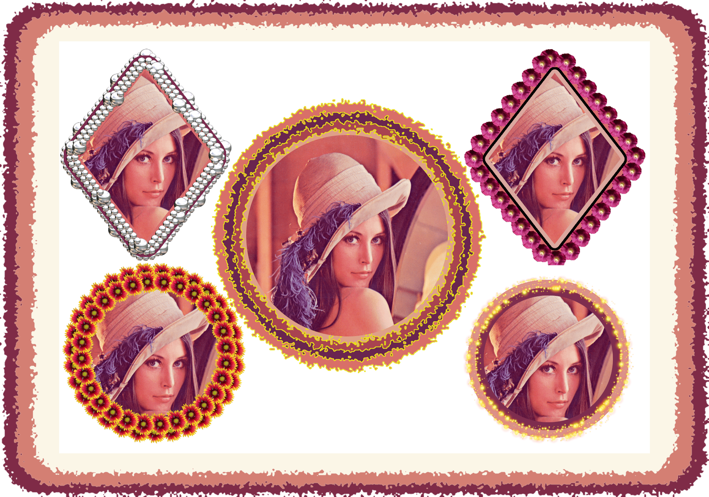

sample_color_border v.1.9..zip [7.28 KiB]
Downloaded 137 times

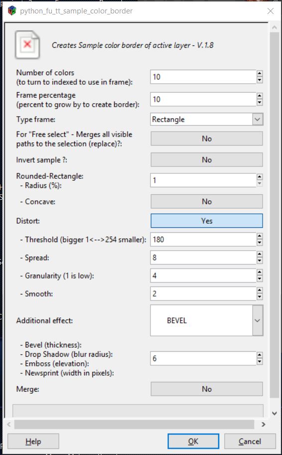

PostPosted: Mon Mar 18, 2019 11:26 pm  (#29)
Ver 1.8 also shuts down after I try a few times. I had not tried 1.8 yet when I saw you had ver 1.9. so I deleted the 1.8. Since having so much trouble with 1.9, even the most simple of the borders does not finish correctly or jams and never finishes. Tried the regular 64 bit 1.8 but having same problem. I did not get the 1.7 so I can try it now, and I will try the 32 bit one you posted.
Gimp crash error message.zip [3.18 KiB]
Downloaded 120 times

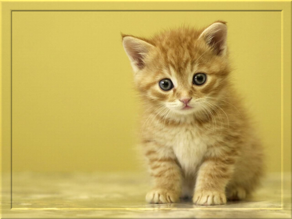

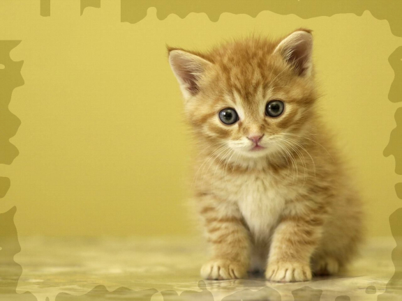

Image frame done with 32 bit Sample Color Border 1.9 without Felimage.JPG [ 188.95 KiB | Viewed 2420 times ]
