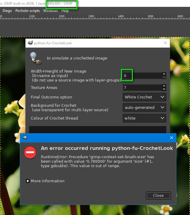

Such a case is also possible:

You choose a too small dimension.
(There was an indication for the user to choose W+U of at least 2000, it has been recently removed to introduce new warnings).
Added a check in the filter, which set now automatically the out size to the minimum of 2000.

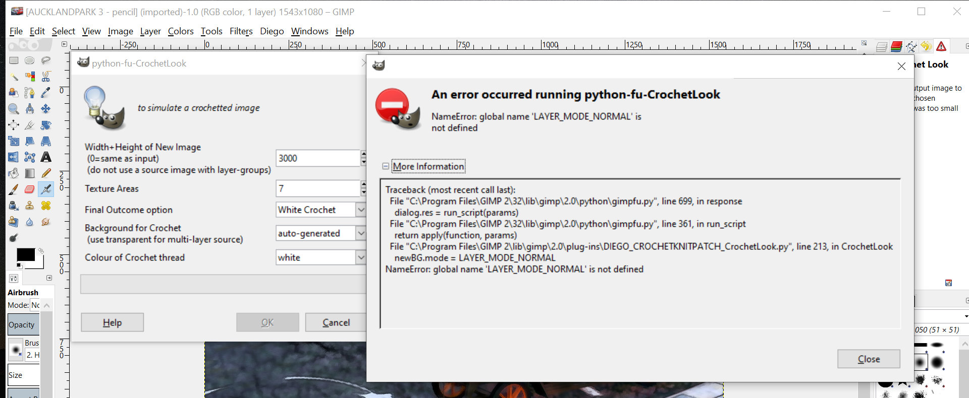

Sorry for replying so late. I think I had an error message but it still ran. I'll try it again and see what happens.
EDIT : Not responding on a 1280x 853 image - new image 3000, texture areas 7, transparent background but my computer is on go slow at the moment. Something is happening now.
EDIT again : - It completed

If you have a slow computer, you may reduce 3000 to 2400, time will be approx reduced by 40%.
The message you got was possibly due to an automatic adjustment of the size:
- if you run it with size=0 and the source has a W+H < 2000, the filter set size to 2000 informing the user.
In general when one of my filters gives a msg then continues to run, it's only to inform the user, no errors.

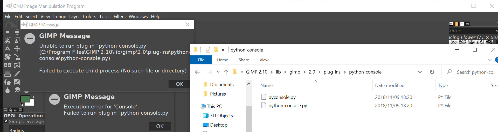

I have installed the DIEGO filter in both Gimp 2.8 and Gimp 2.10.
In Gimp 2.8 it shows up but don't run correctly and in Gimp 2.10 it don't show up at all.
My friend who has Gimp 2.10 (same version) has no problem and it works for him.
Here are screenshots with both versions and the problems.
Gimp 2.8 screenshot:
Gimp 2.10 screenshot:
I am a newbie and not sure why this can be. My friend saw my screenshot for 2.10 and it looks fine how it is setup in Windows.
I have noticed some other filters overwriting each other when I install them, i.e. Xero filters works but when I install Artistic filters, the Xero disappears from the list or vice versa. This is on Gimp 2.10.
This tells me the problem lay in the plugins setup.
I really hope that I can get the Diego crochet filter to work as it works on my friend's.
Thank you for your time,
Laura

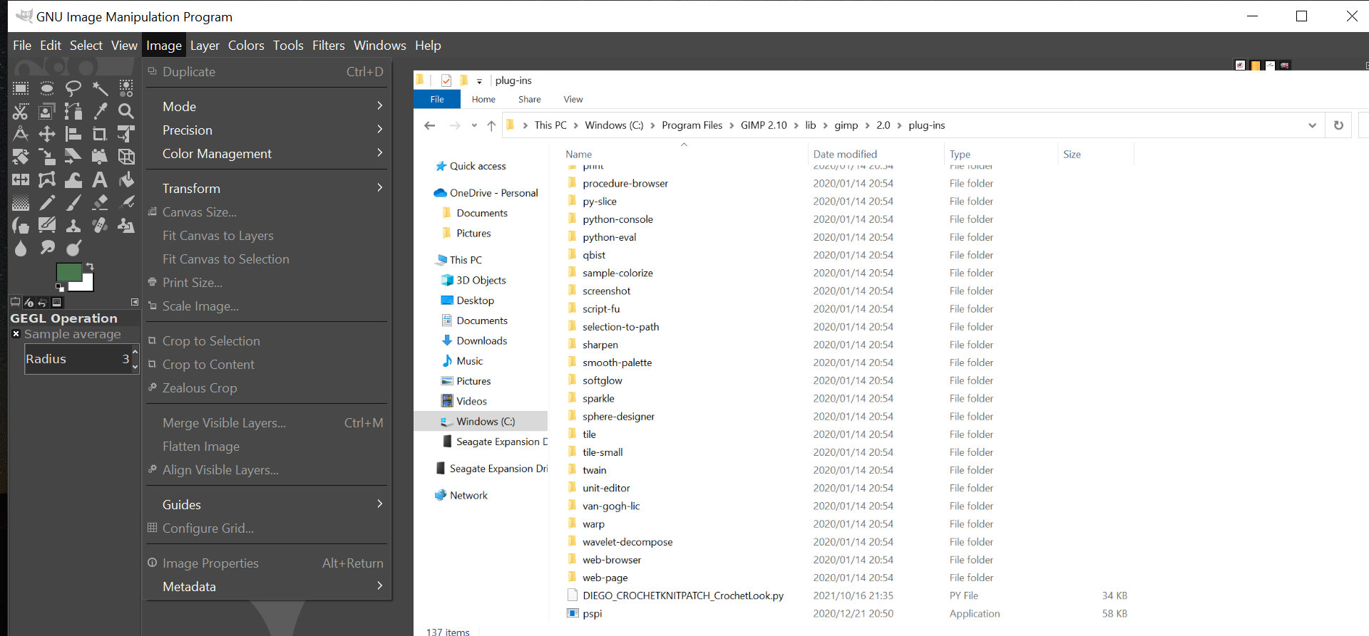

Thanks for trying Laura.
In 2.8 it can't run (unless changes are made to "restore" old parameters).
in 2.10 it should run without problems, I do not understand the reference to "console", did you try to run it from the console?
"CrochetLook" should appear under menu "<Image>/Diego/CrochetKnitPatch", which I do not see it in your snapshot for 2.10. Ask your friend whether he sees that menu entry and the steps he used. I hope you succeed too, good luck!
I have made another screenshot of Gimp 2.10 (shown above) and the Menu > Image but it don't show up there, on the screenshot you can see where the Diego is installed. If it's wrong please tell me.
My friend's "Diego" appears on his main menu bar on top between tools, filters or windows and he runs it straight from there. I will chat with him this evening and ask him if it's showing up also under Image or not.
