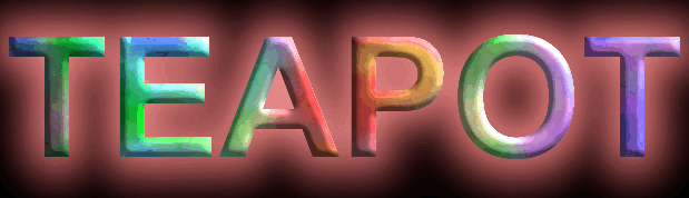

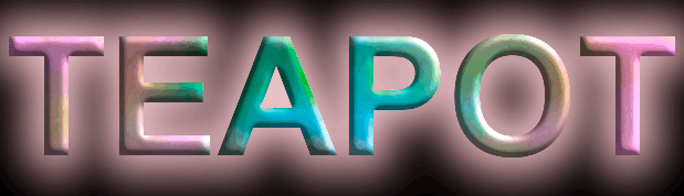

Thank you for your nice comments Sallyanne, Issabella and PixLab.
PixLab wrote:
Very nice teapot! :clap
Let me guess, did you strike a path with a brush where dynamics is color from gradient, then your script/tuto?
I'm thinking to wake up the thread "Decoding your text" :hehe
Yes that's right :hehe
My steps were:
Make a path.
Select the 'Pastel Rainbow' gradient.
Select brush '2. Hardness 100' but other brushes work too so long as the spacing is quite small, I used spacing 10.
Brush dynamics 'Colour from gradient'.
Repeat 'Sawtooth wave'.
On a transparent layer, stroke the path with:
Stroke with a paint tool.
Paint tool: Paintbrush
Python-Fu -> Rotate Hue
Step 20
Add a background layer to each frame, save as an animation.
Variation with a different brush, and dynamics:

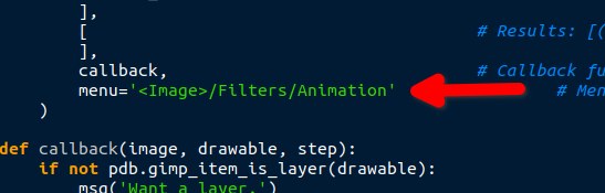

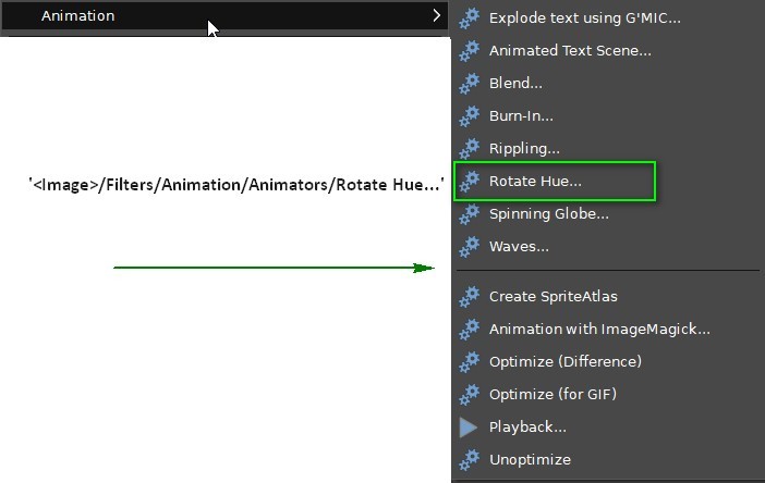

I have two minor comments about it:
- for animation plugins it should be possible to specify the number of frames (so steps=360/frame
- location in the menu: why not more adequate:
"<Image>/Filters/Animation/Animators"
Regarding Gegl (the hardest first step) :mrgreen:
gegl_command by Kevin Payne & Claude Lion [cli345] here: viewtopic.php?f=9&t=18040&start=30p264354
(for the convenience of users, I paste this code into every plugin that uses GEGL - and it is required for Windows)
In your plugin you just need to replace the line:
pdb.gimp_drawable_hue_saturation(new_layer, HUE_RANGE_ALL, hue_offset, lightness, saturation, overlap)
to:
gegl_command(image, new_layer,"hue-chroma hue=%f" % (hue_offset))

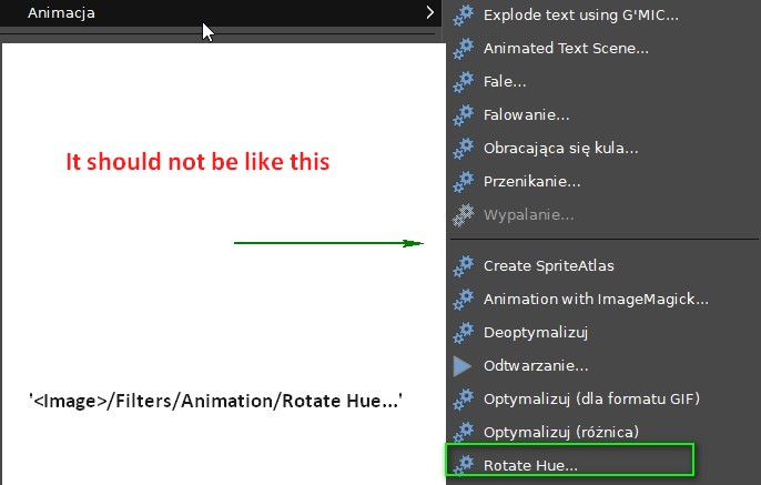

Hi MareroQ
Nice idea to change the menu path, but in my humble opinion, adding "Animators" as a sub-sub-sub menu is becoming too long, I already did a change on the one I did downloaded, I did put it directly in "Animation" (no third sub menu) :mrgreen:
Ella, teapot and diagrajamal1 your last ones very :coolthup :bigthup
Patrice
PostPosted: Wed Jun 28, 2023 1:42 am  (#35)
Hi PixLab.
When you look at the code without trying it, "Animators" seem to create an extra submenu. :hehe
But it's not like that. :gaah
You've noticed that the "Animation" menu is divided into two sections;
- top: for various creative animations,
- lower: for generic tools?
Adding "Animators" just tells Gimpwi to place the plugin over the dash (and it doesn't show).
And one more thing: three dots [...] at the end of the plugin name indicate that the GUI has been displayed (no dots - the plugin will run automatically as there are no options to choose from)

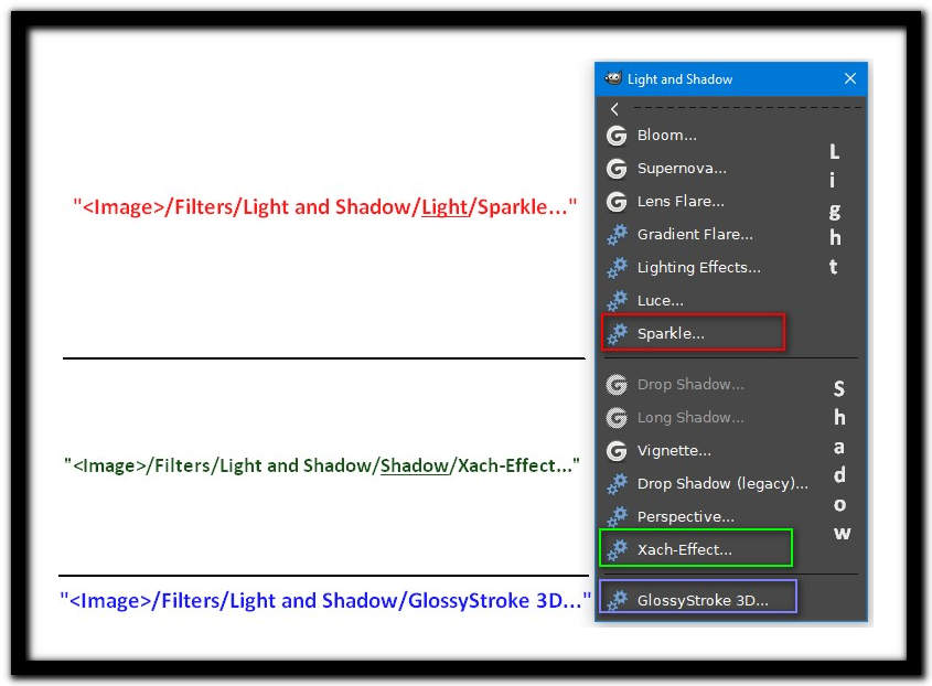

Do you know if it's the same wording for others menus? In Light and Shadow (Filters > Light & Shadow) there are 2 dashes/3 blocks, how can you define the top/the one in between/ and the bottom?
Again a big-big :tyspin
Patrice
PostPosted: Wed Jun 28, 2023 10:45 pm  (#38)
@ PixLab
I gave You a 'fish', not a 'fishing rod'... :oops:
This can be easily deduced from the "pluginrc" file or from the xml files in ...\share\gimp\2.0\menus\ (a bit more complicated).
You can also look at a specific plugin or script. :)
