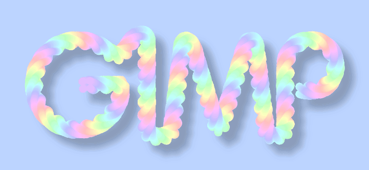

Thank you for your nice comments Sallyanne, Issabella and PixLab.
PixLab wrote:
Very nice teapot! :clap
Let me guess, did you strike a path with a brush where dynamics is color from gradient, then your script/tuto?
I'm thinking to wake up the thread "Decoding your text" :hehe
Yes that's right :hehe
My steps were:
Make a path.
Select the 'Pastel Rainbow' gradient.
Select brush '2. Hardness 100' but other brushes work too so long as the spacing is quite small, I used spacing 10.
Brush dynamics 'Colour from gradient'.
Repeat 'Sawtooth wave'.
On a transparent layer, stroke the path with:
Stroke with a paint tool.
Paint tool: Paintbrush
Python-Fu -> Rotate Hue
Step 20
Add a background layer to each frame, save as an animation.
Variation with a different brush, and dynamics:

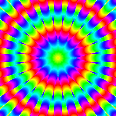

Ella, Thanks for trying it out I'm loving the teapot :jumpclap
diagrajamal1, very nice kaleidoscope effect :clap
