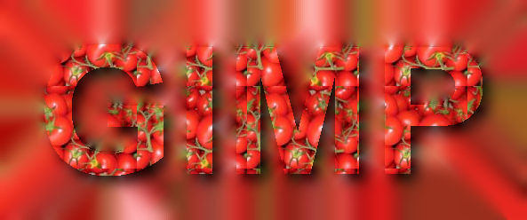

I keep playing with this script. I beveled the text with this one.

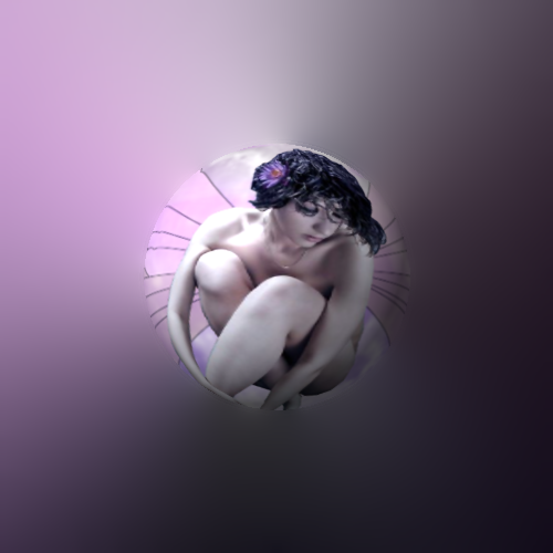

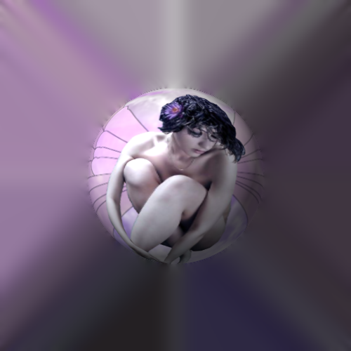

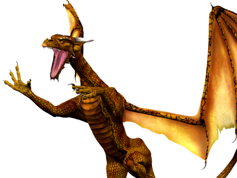

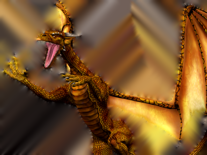

Ronounours wrote:
I would be interested also by any comparison with the RobA algorithm.
Quite different results - both very interesting.

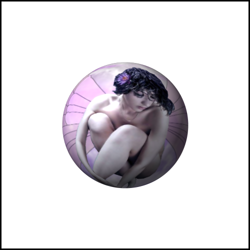

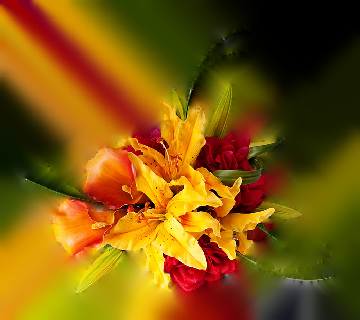

 Post subject: Re: Alternative script to Flaming Pear Solidify filter
PostPosted: Thu Dec 01, 2011 3:10 pm  (#31)
Joined: Jan 03, 2011
Posts: 1656
RobA : Yes, I've tried with larger eroding and dilating elements but in that case it creates less smooth transitions. Anyway, I've got another idea that I must test before doing something else :)
Lyle : In your example too it is really clear how it favors 45° angles.
PostPosted: Thu Dec 01, 2011 3:12 pm  (#32)
the gmic version

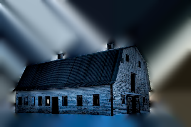

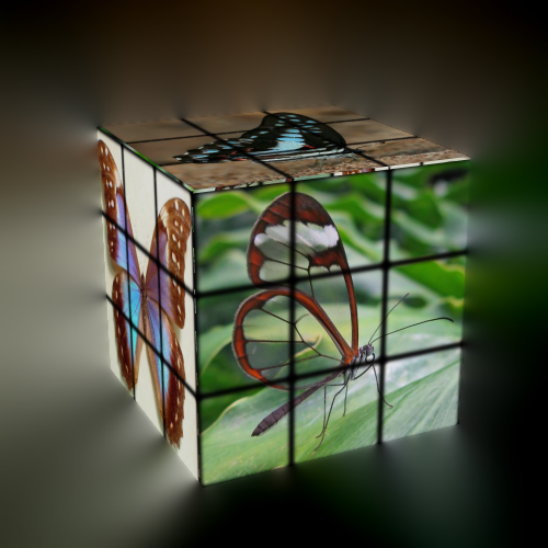

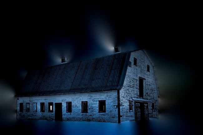

Here are my two to compare.
GMIC
RobA
PostPosted: Thu Dec 01, 2011 6:35 pm  (#40)

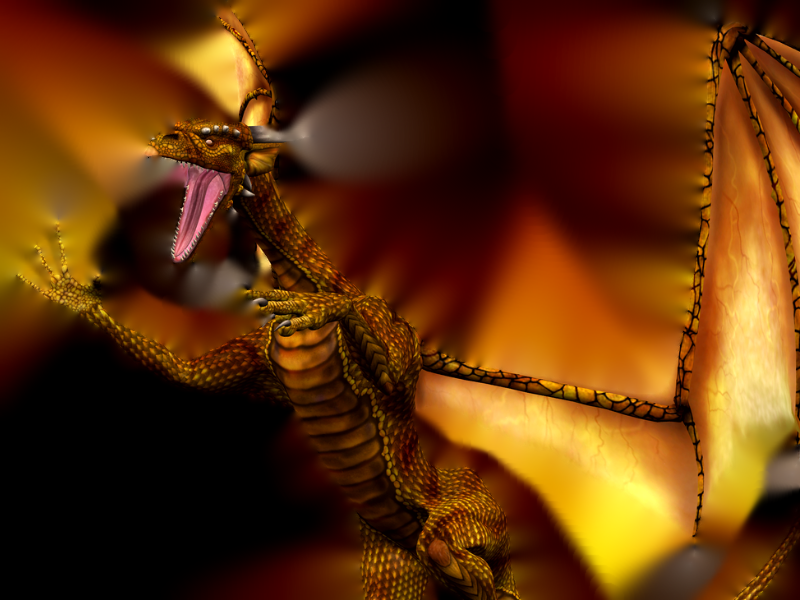

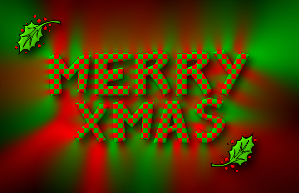

For speed RobA's(set at 10) is faster these are the results they returned
Gimp RobA's
Gmic
The setting on RobA's seems to effect the coloring at the bottom of the image more than the speed of the fill.
