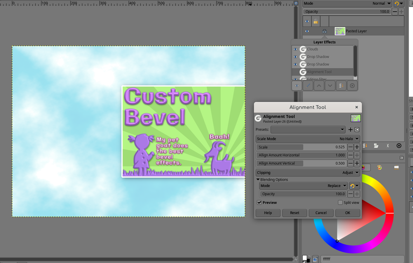

There are two things I am posting about here. First, I have no idea why but sometimes warp transform is non-destructive and other times it is not non-destructive.
Unrelated to warp transform I found an interesting behaviour that involves the preview line and non-destructive filters. Below is a screenshot of my GEGL plugins "align tool" and "Clouds" being used with two drop shadows. All non-destructive and clouds is using the "behind" blend mode.
When I split preview my plugin "alignment" it shows all three other filters conforming to the split view, clouds looks normal but the two drop shadows that make an outline and shadow are applying on the split preview line.
To download these two plugins go here. They work in Gimp 2.10 as well (destructive of course)

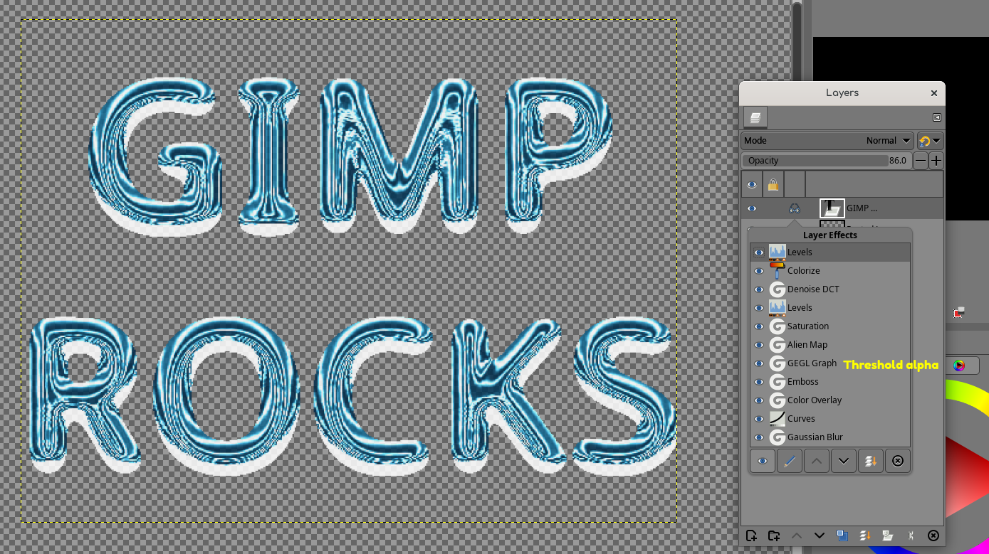

Here is me trying to recreate my advance text styling plugins with native Gimp filters alone and no plugins of mine or GEGL Graph syntax. The one exception is a GEGL Graph that calls gimp:threshold-alpha because I could not find that command in the menu.
This GMM plugin mock up fails hard because there is no id and ref
However recreating simple plugins of mine using GEGL filters alone in Gimp does work because they are simple.

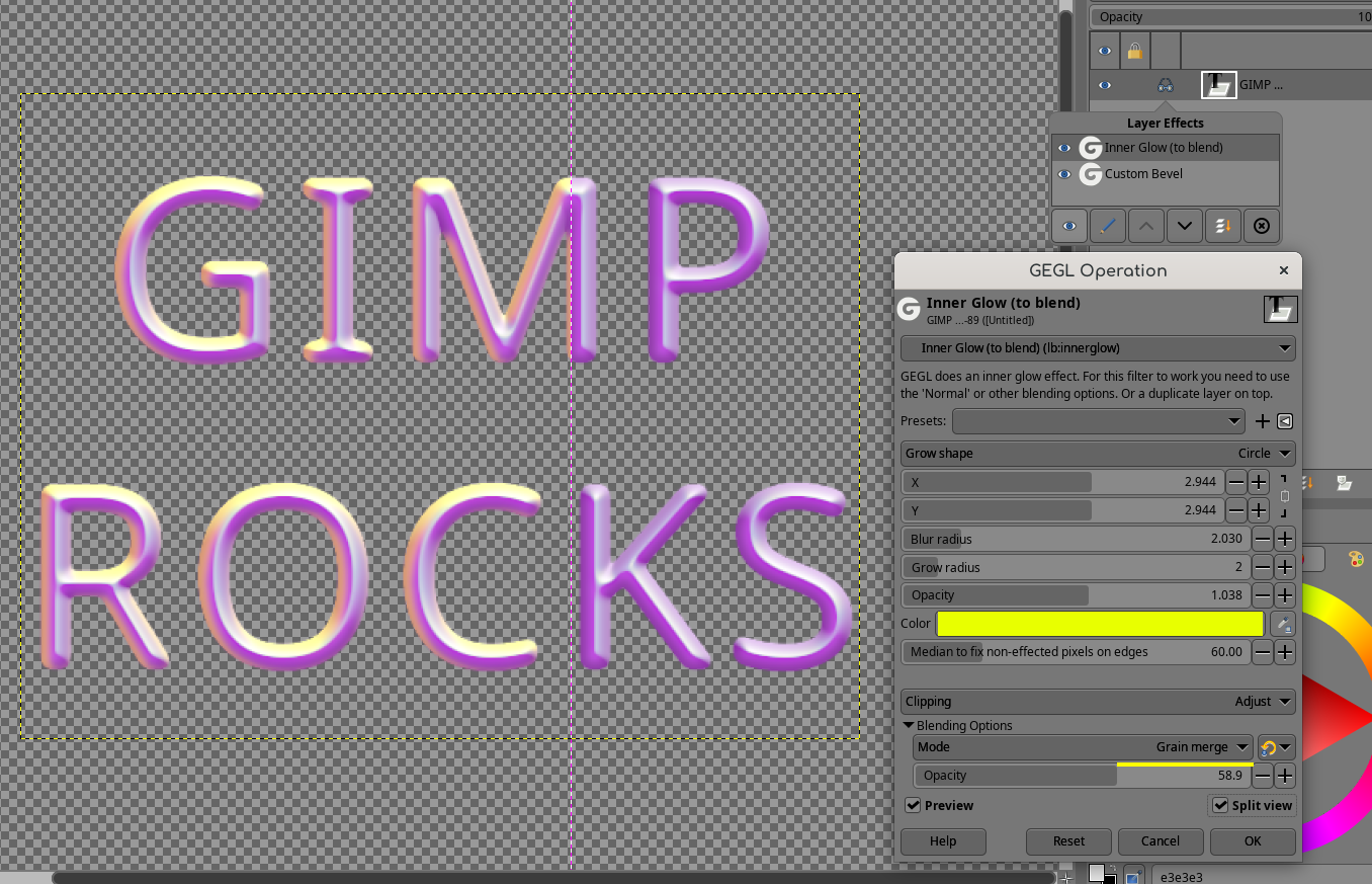

Back in 2022 one person told me once Gimp gets non-destructive editing they will be able to have workflows similar to my GEGL Graph syntax writing. This is mostly wrong outside of simple things and here I will explain why in clear detail.
This is the code to render my inner glow plugin in GEGL Graph without installing it. The 9 underlined commands are options that are available in GEGL Graph syntax within Gimp, but not Gimp's GUI and even if they were available in Gimp's GUI it would just be a complicated list of dozens of non-destructive filters instead of just one filter called "Inner Glow".
id=0 src-in aux=[ ref=0 id=1 dst-atop   aux=[  ref=1 distance-transform  ] xor srgb=true     aux=[ ref=1 ] color-overlay value=#000000 dropshadow x=0 y=0 grow-radius=5 color-overlay value=#ff0000  ]
median-blur radius=3 alpha-percentile=94
crop
Here is a preview of my plugins "Custom Bevel" and "Inner Glow" chained together. Inner Glow is blended with Grain Merge and is on mid opacity. If this was possible without my plugins (which it isn't) it would take dozens of filters (probably like 30) instead of just two.

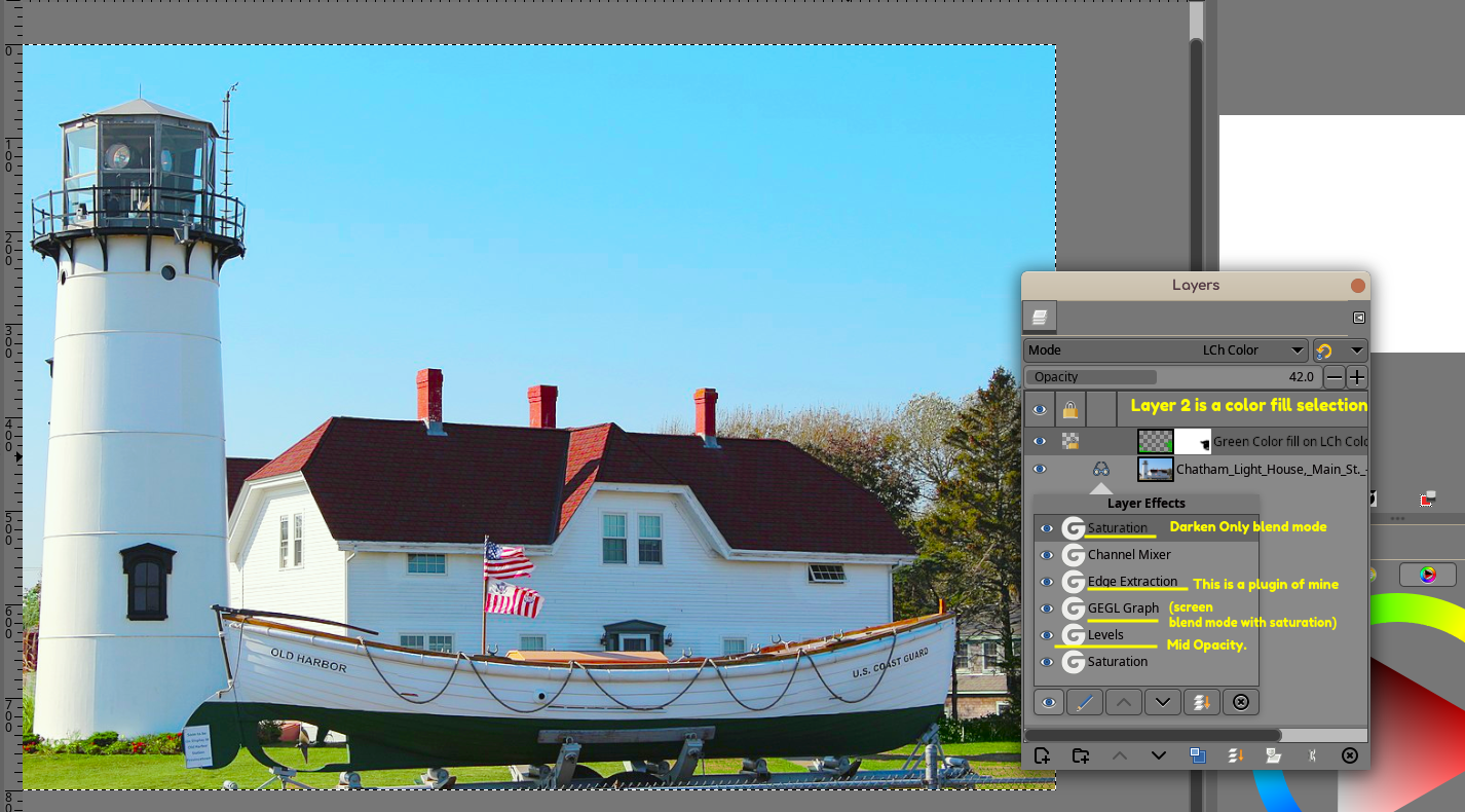

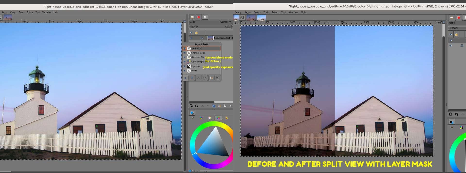

I figured out how to make this build usable for real work of mine. I can pretty much use any filter except Hue Saturation and Curves and I have to use the Levels in GEGL operations not the normal one in the main menu. If I don't do this those filters will work until restart where the .xcf will be corrupted.
I also run
flatpak run org.gimp.GIMP -n on my machine to access normal Gimp 2.10 or Gimp 2.99 that is not non-destructive. The N is for new instance so multiple versions of Gimp can run together.
Moving on to the workflow of the light house building...
Original Image WITHOUT EDITS
Edits preview - Layer 2 is an green selection on LCh Color and has no filters
Final Result Maybe I should have done a hue-saturation on red to brighten the roof? but that would have corrupted the xcf file on restart

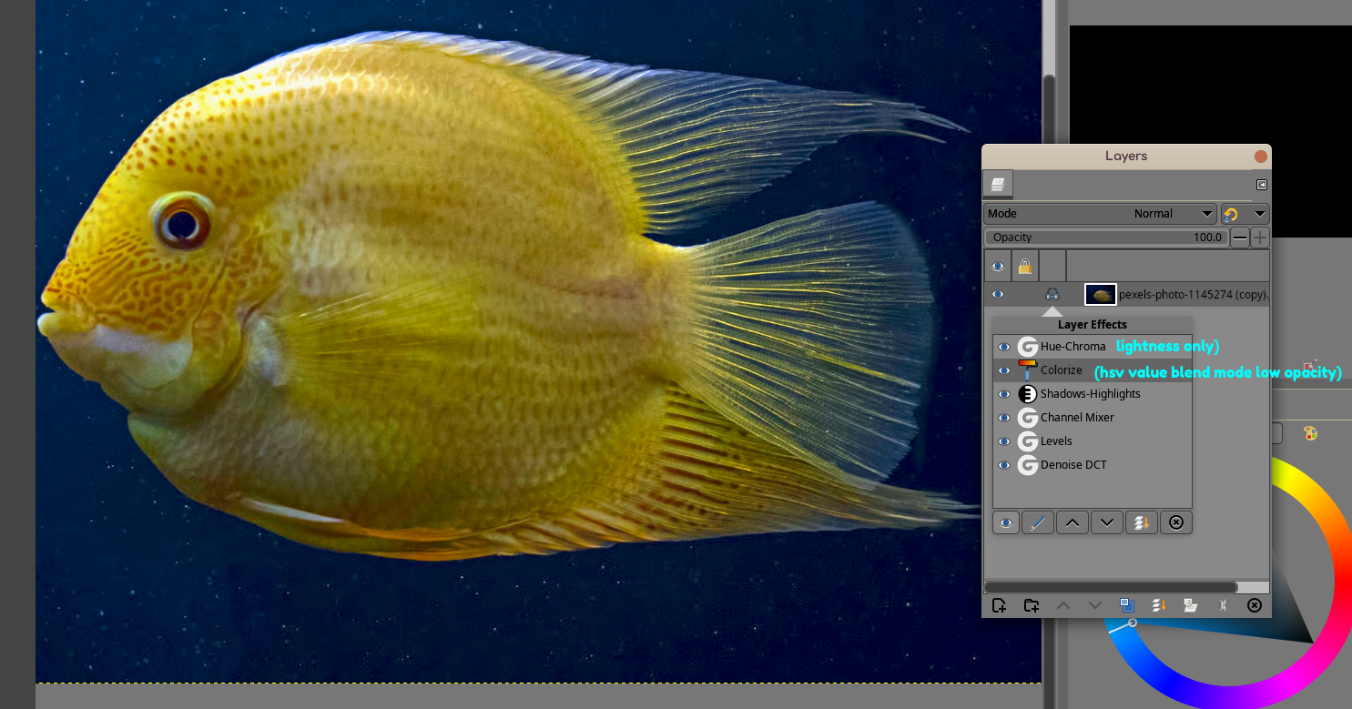

I used the "Brightness Contrast" in GEGL operations as the one in Gimp's main menu causes the corruption on reopening the xcf.
Original Image
GEGL Edits showing the layer effects

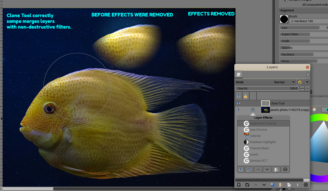

Regarding the clone tool. Unlike the color picker and selection tool it actually does remember layer info it samples
If you run the clone tool with effects it will remember them. If you run the clone tool without effects it will NOT remember them.
THIS IS GREAT!!!

I am DYING to be notified about an update where CMYK Student's build remembers colors. (like I can run drop shadow, change the color and it is not reset to a default color) Because I figured out how to make this part of my workflow in Gimp but the limitations are huge. No layer mask, no to most (gimp:) menu operations and no to any filter that has a color picker on non default options.
Original Image (resized and cropped)
During Modification time
Modified Image with GEGL filters

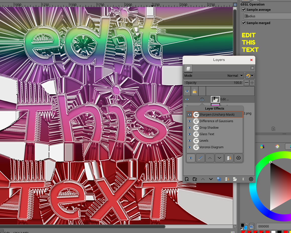

This build of Gimp has a new GEGL filter called Voronoi diagram which is basically a port of an old gimp script fu to GEGL made by someone else back in the early 2000s. I decided to chain this new filter with sharpening filters and my plugin "Glass Text"
To learn more about my plugin "glass text" go here.
https://github.com/LinuxBeaver/Glass_Te ... /GlassText
Here is novel Voronoi Diagram, Levels, Glass Text (my plugin), Drop Shadow, Difference of Gaussian (Overlay) and Sharpen together. It is editable.
Now the background is a gradient to make it cooler.
Now its off the charts awesome

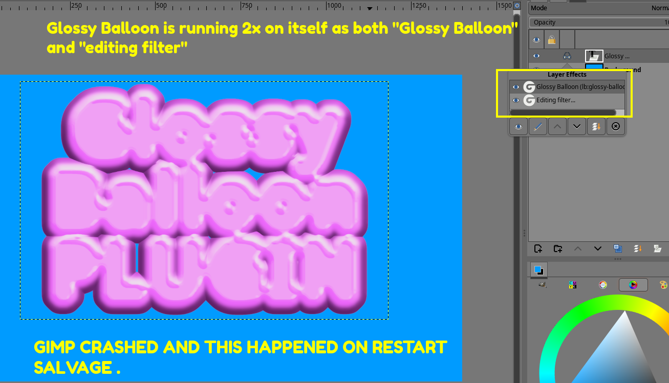

NEW BUG FOUND WHILE MAKING THIS POST!
I restored the session after Gimp crashed when Glossy Balloon was running and then this happened.
Glossy Balloon double stacked as both itself and another copy of itself named "Editing Filter".
@CMYK_Student, check out this bug!

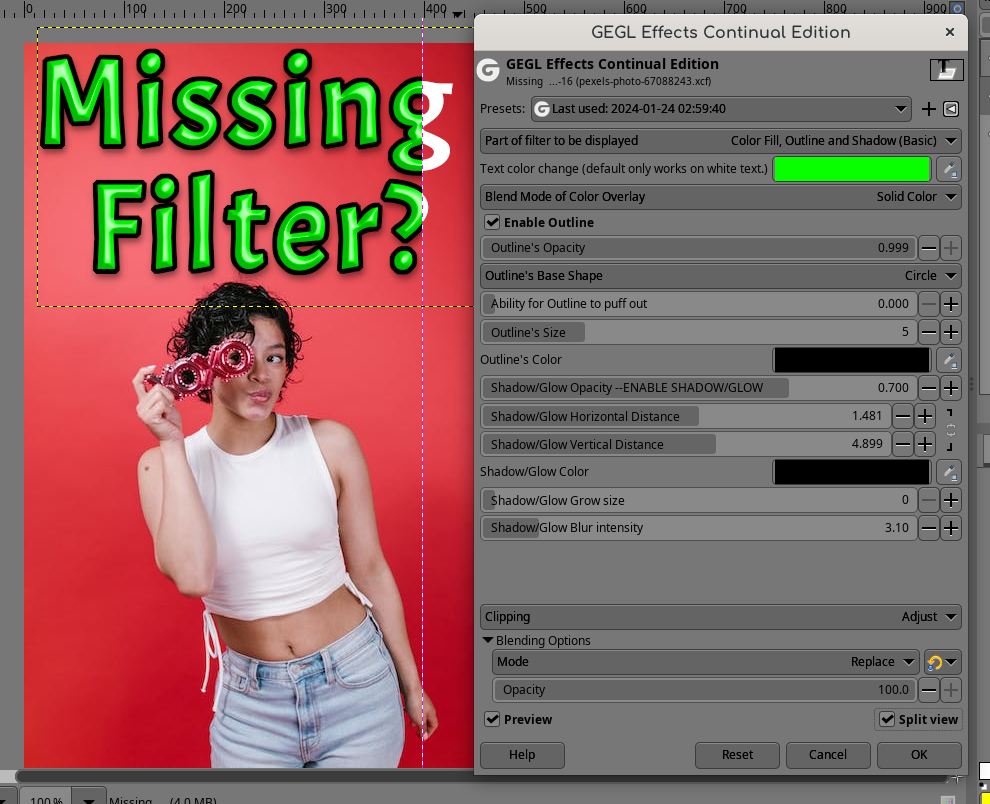

2. Missing GEGL plugins report nothing but it doesn't crash Gimp anymore.
GEGL Effects CE is a non-destructive filter and if I remove its binaries from
/home/contrast/.local/share/gegl-0.4/plug-ins and restart Gimp there is no crash (unlike before) but still no warning either.
Here is GEGL Effects applying and after doing this I put an RGB noise filter below it.
Then I removed GEGL Effects binary and restarted Gimp and only RGB noise booted.
We are making progress!

Good to hear. I found a work around by writing GEGL syntax (shown below) just to make up for the fact that it does NOT remember gegl:color
Reduce Color Green (color overlay on grain extract 0.09 opacity)
gimp:layer-mode layer-mode=grain-extract opacity=0.09 blend-space=rgb-perceptual
aux=[ color value=#34ff00 ]
and
Outline Blue
dropshadow x=0 y=0 radius=0.5 grow-radius=5 opacity=1 color=#0083ff
It remembers the syntax html color code atleast.
