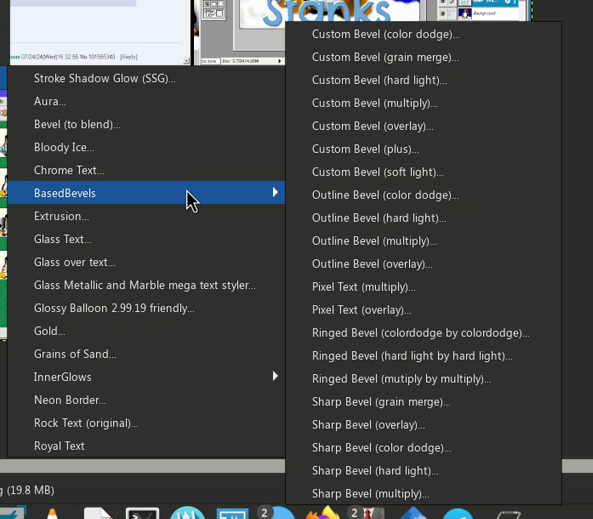

Update - source code of all sactioned plugins - binaries are coming soon - they no longer use Malloc
GIMP3_BUNKER.zip [315.53 KiB]
Downloaded 67 times
Because none of my plugins use malloc in GIMP we we have a plugin for each bevel blend mode.

Sad news. My plugins are still crashing on closing a tab and GIMP even when references to malloc and state-> are gone. My plugins are ultra simplistic and have pure gegl syntax but the crash still occurs. :(
GEGL gives no warning why the crash happens. GEGL assures me my syntax is perfect. The problem is how GIMP stores information... it might not be able to store huge amounts of GEGL nodes but this was never a problem in GIMP 2.10 because everything was destructive. I'm losing hope I can't do anymore.

ok, I have 60 plugins that are assumed safe on GIMP 3. I am testing them now. This is exhausting and tedious.
