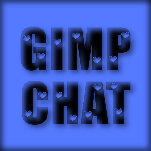

GnuTux a bug that has been in the script is its inability to do an inverted glow on a layer (the same dimension as the Image) without selecting resize as well
Using a inverted glow on a background is a very nice effect as shown below
the way to avoid this is that after your 'gimp-selection-layer-alpha' check your selection width and height then if either of them = your image width or height shrink you selection by 1
I proved this by on the layer doing a 'Select All' shrinking by 1 then running script(de-selting allow resize), I can wright up the procedure for you tomorrow if you like as there is not much involved and I know you are busy at the moment
