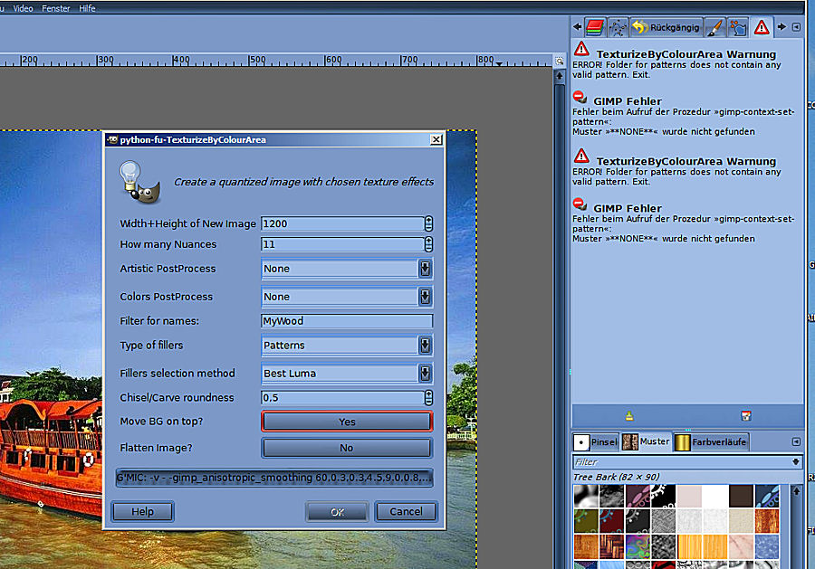

Joined: Jun 16, 2016
Posts: 137

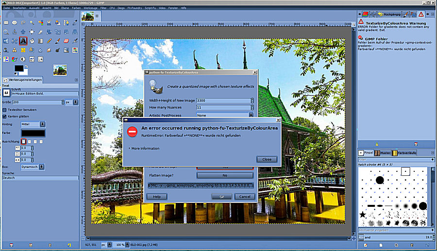

Hello ,
when I use the filter I get the error message
according to picture .
What am I doing wrong?
Regards Hardy111
 Post subject: Re: new filter "TexturizeByColourArea"
PostPosted: Fri Jun 17, 2016 9:01 am  (#78)
If I understand correctly
- you have selected "gradients" as type of filler
- but the filtering name entered for searching the gradients available in your folder didn't find any
Please look at the name of the gradients you have and select from them
In case you want to change the name look at my previous post related to the procedure to change gradients names
PostPosted: Fri Jun 17, 2016 9:03 am  (#79)
I guess it's easier for everybody to start with patterns first...
But always looking at what is available in your folder.
PostPosted: Fri Jun 17, 2016 9:40 am  (#80)
Posts: 137

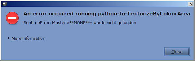

Hello,
the plugin is installed in the below directories :
C:\Benutzer\Reinhard\Eigene Dokumente/Gimp 28/py-plug
C:\Benutzer\Reinhard\Eigene Dokumente/Gimp 28/pattern
I think the plugin does not find the pattern or Gradients .
Below is a screenshot of the error again .
Or is the problem that use German version of Gimp?
The script does not find the pattern and the gradient
Regards Hardy111
