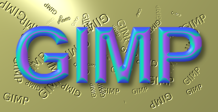

Thanks, GnuTux. That background was really easy to make.
I used the Text tool to make the original word GIMP with Sans font size 39. Copied it to the clipboard. Made the FG color dark gray and the BG color a lighter gray. Made a white layer, and a transparent layer on top of that. Dynamics were set at Dynamics Random. I used the clipboard brush to randomly brush and worked at it a bit. Merged that layer down to the white layer. Made a new layer and filled it with a soft yellow. Made it the active layer.
Then Filters / Light & Shadow / Lighting Effects. Clicked the Bump Map tab, made Maximum Height 0.01, found the black and white layer in the dropdown list and voila!

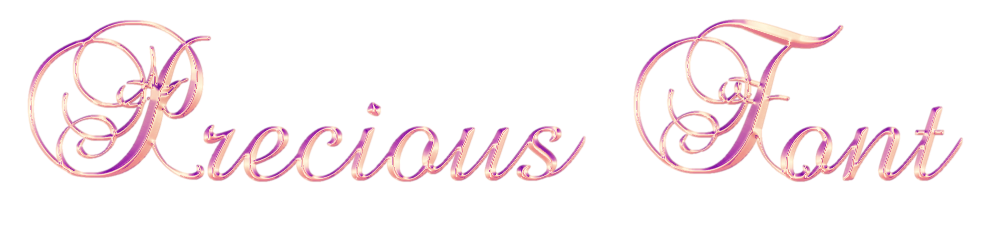

Nice outcomes, Oregonian, Sallyanne and SysTemX. I like them. :hi5
I think the font used by Sallyanne is "precious"

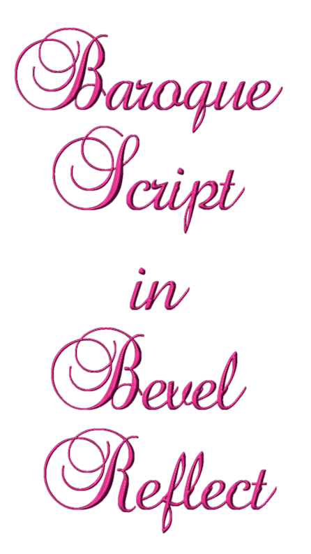

Precious is beautiful and pretty similar but I instead used
@ Oregonian it is here
http://fonts.webtoolhub.com/?prefix=baroque+script
WOT says the page is safe. I can't remember where I got it from, doesn't look to be at dafont.

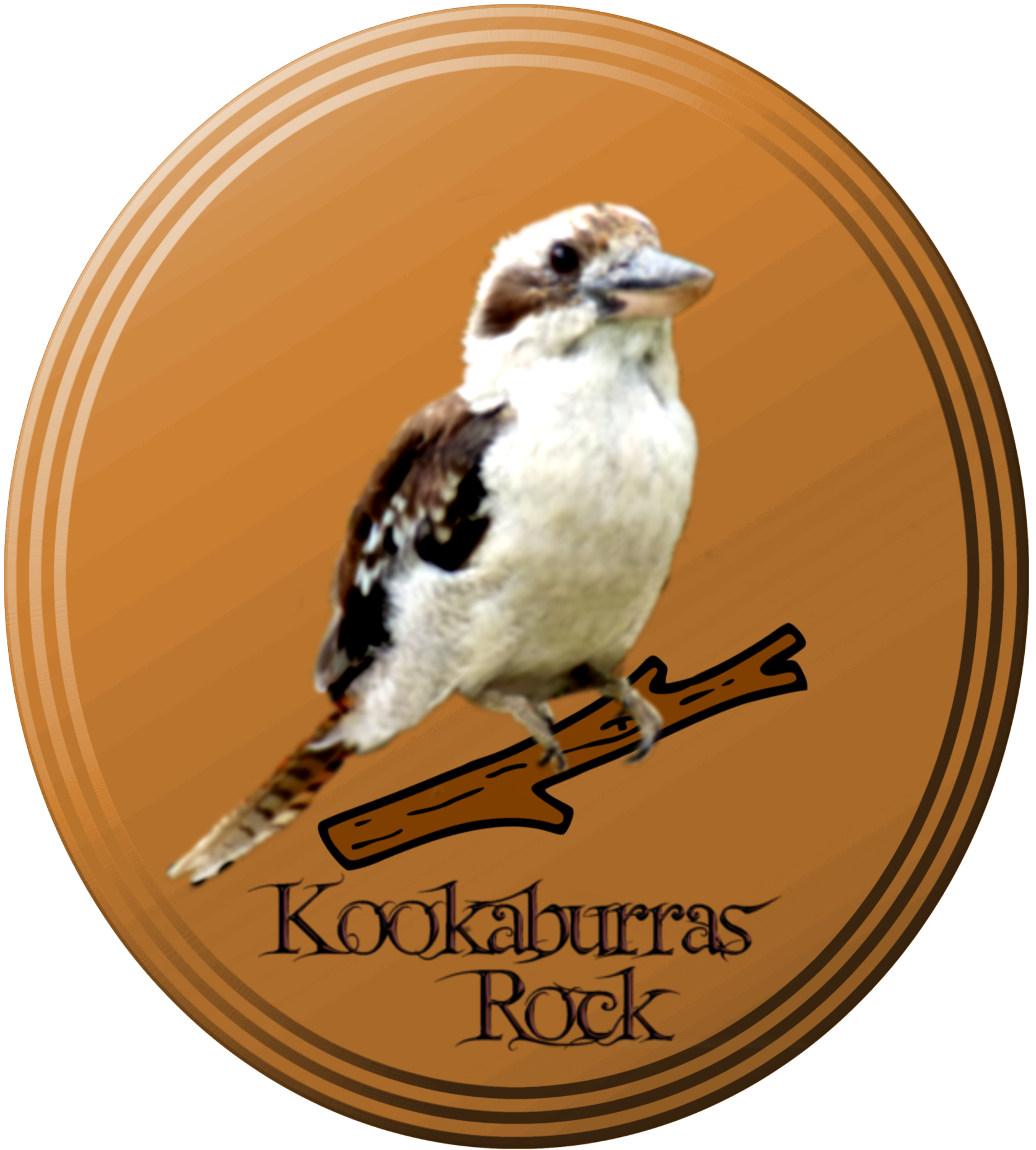

Edit ... what a day learning layer masks, stepped chisel and BRL; thanks again to GnuTux, Graechan and others who have provide assistance; so I used all three techniques and built you a plaque to say thanks!
File comment: thankyou plaque

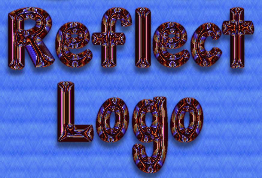

PostPosted: Fri Oct 10, 2014 11:10 pm  (#737)
Very nice effect on that one, Warrior. :cool
