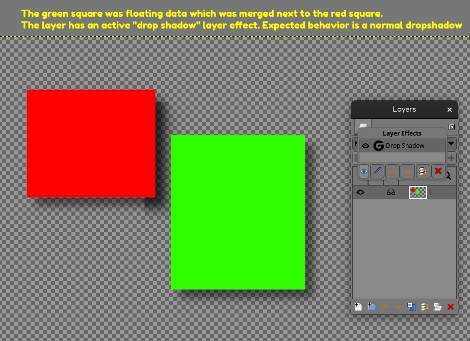

Joined: Oct 31, 2020
Posts: 2025
Drop Shadow and my plugin Inner Glow being applied non-destructively in 2.99.19
Their custom clors are remembered

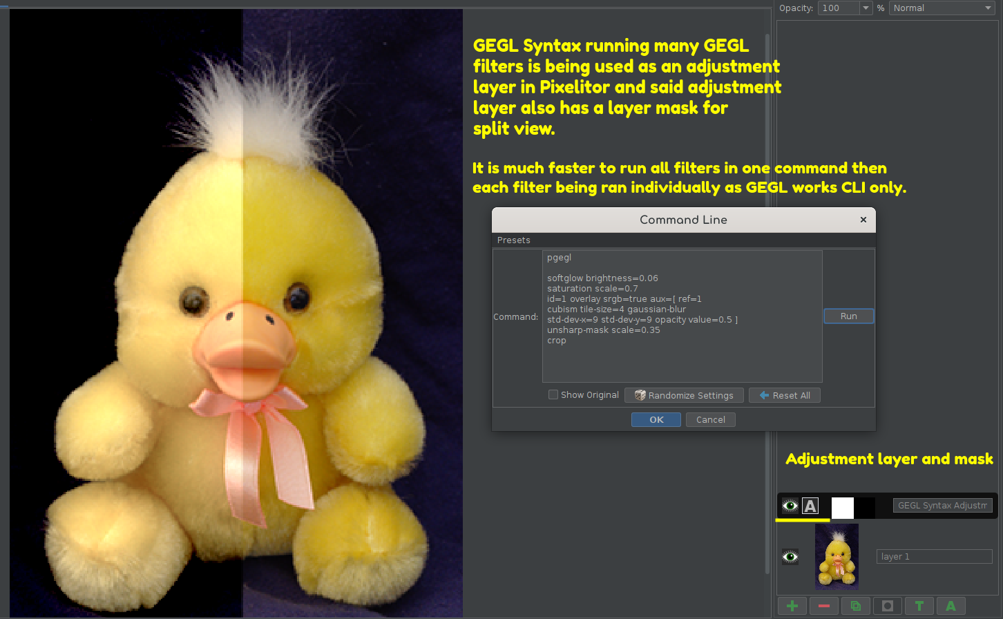

I've been compiling Gimp 2.99 from Jan 1st 2023 until today. Feb 21 2024. This Gimp 2.99.19 special branch may be the first release I consider usable for real world work. Though we still have ways to go such.
IMO, Four new goals should exist for CMYK Student in order to comply with professional standards
1. Make it in default where all filters are destructive until a layer is converted into an "effects" layer. Add a section in menus called "convert to effects layer" with a GEGL icon. If they de-convert it all effects are rasterized unless it is text. Perhaps we can make it where text layers are 'effect layers' by default but normal layers and layer mask are not.
2. Add non-destructive filters on Layer mask. When of course they are converted to 'effect layers'.
3. Make it where each effect layer has its own layer mask EXCEPT for effect layer of a layer mask. IMO there is no need to give channels effect layers.
4. PLEASE DO NOT MAKE ADJUSTMENT LAYER GROUPS. Instead just make normal adjustment layers like Photoshop and Pixelitor. It can work by adding a gegl graph to each layer below it. Unless a layer group on normal cancels the adjustment layer effect. We might even be able to make it where the adjustment layer goes both up and down or ignores specified layers. But historically a adjustment layer inside a normal layer group is cancelled. From a very technical view point "adjustment layers" can be thought of as "layer effects" that have clone filters on many layers below them. In default Photoshop and Pixelitor only have the ability to use adjustment layers of fast color lighting filters but Pixelitor allows ANYTHING to be an adjustment layer if users left clicks the adjustment layer icon and select a filter. I do not have the ability to test Photoshop after 2010, so its possible CC can do this now.
I am serious about Adjustment layer groups being a bad idea.
Here is a preview of adjustment layers in an open source program called Pixelitor. You have to enable experimental features to use them but trust me they are stable as I've been using them for almost two years. Pixelitor can also call GEGL from the command line bash and that too can be used as an adjustment layer, but it is very slow and syntax only (for GEGL and GMIC, not native filters, they are fast). In Pixelitor adjustment layers apply something like "gegl graphs" to every layer below them unless blocked out by a "normal layer group".
https://github.com/lbalazscs/Pixelitor
Pixelitor using its Gradient Map filter as an adjustment layer
Pixelitor using GEGL syntax "command line filter" as an adjustment layer.

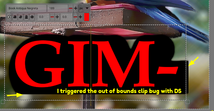

I triggered the out of bounds bug by making a composition with text and dropshadow then moving and expanding the text layer.
Please manipulate the text layers corners in hopes of triggering the out of bounds text bug yourself.
We can solve this bug. I believe in your CMYK Student!

@CMYK_Student I found a bug that is very easy to duplicate.
I duplicated a composition and two layers with non-destructive filters were in a "normal" layer group. After duplicating the composition all non-destructive filters were in tact except the ones inside the layer group. Let's solve this bug!

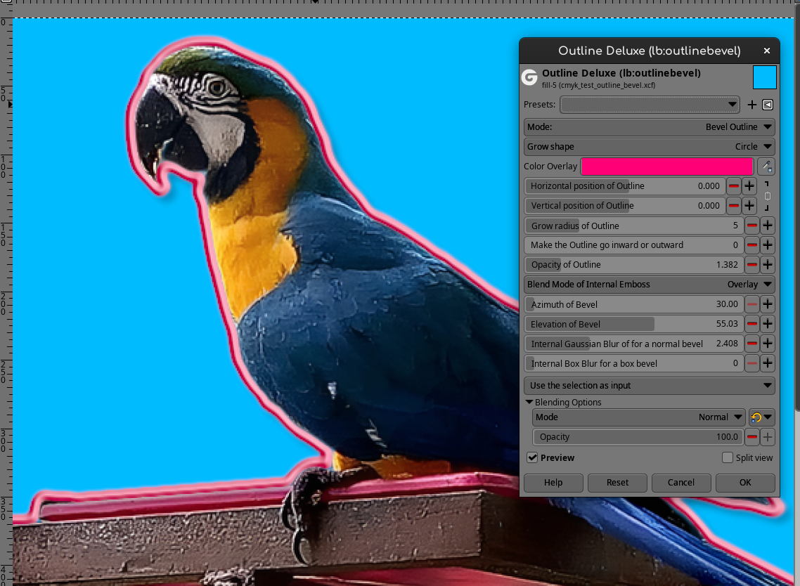

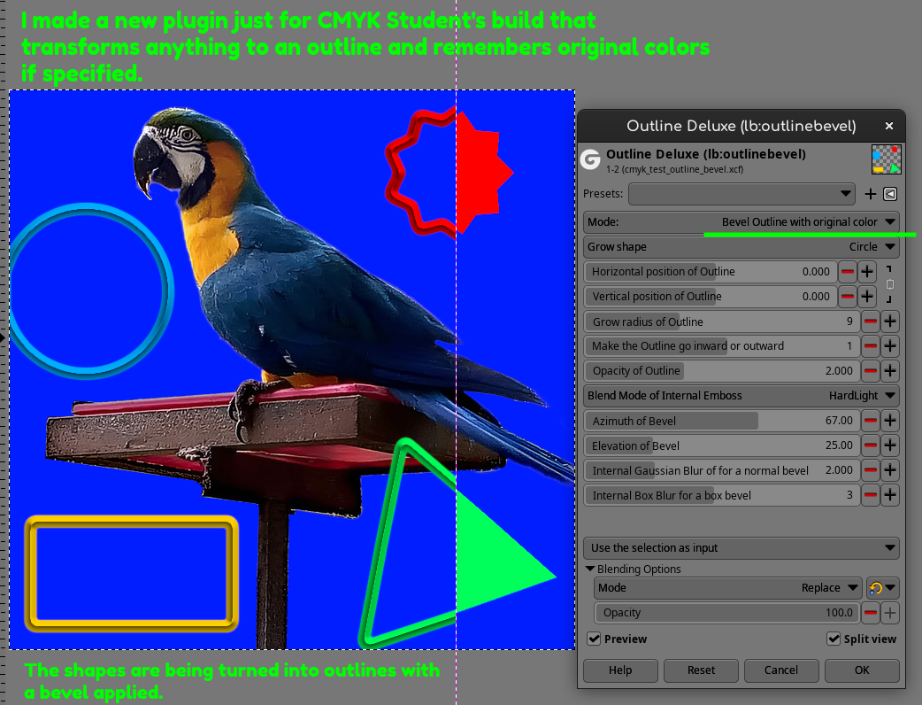

Congrats for the inspiration. CMYK Student's 2.99 Gimp build inspired me to make a new unreleased plugin that remembers the original color of an image before doing an "outline only" effect. Said unreleased GEGL plugin depends on two other plugins of mine SSG and Custom Bevel. Users can now use shape brush packs in Gimp and make real time non-destructive shape outlines or easy bevel outline only text. The plugin also works in Gimp 2.10 but it won't have real time brush abilities.
The technical reason for me making this plugin is so that 2.99 users could make outline only bevels on the same 'layer effect' setting without writing GEGL syntax.
Bevel Mode
Outline Mode
I will make a separate thread when this plugin is released, and due to the fact that Gimp 2.99x currently crashes most of the time when using layer src=/image_here.jpg in the GUI only, This plugin will NOT contain the ability to upload an image file. This would have been a trivial addition but I don't want to make any new plugins that use that feature until that bug is fixed.

Outline Deluxe plugin is released. Download below
https://github.com/LinuxBeaver/Outline- ... n/releases
It has code and binaries and will work on 2.10 and 2.99 but it is specially intended for 2.99.19. Usually I do not release plugins several hours after I make them. This is a quickie exception.

-- Two New bugs caused by the same thing --
Anchoring a floating point with non-destructive filters creates a visual bug on layer with active effects if it is close to it. If the layer is far away enough it won't do that, but eitherway the anchor will double apply and clip the effect, and the original content in the layer will have a destructive effect. The double apply is the effect applying on a destructive layer.
Take the green and red square for example. The red square has always been there as a non-destructive layer. Green is a floating point that is being anchored in the same layer. Now the drop shadow creates a visual clip bug.
Clip bug created by anchoring a floating point on the same layer too close to alpha defined content. I incorrectly used the term "merged"
Drop Shadow applying destructive bug by anchoring a floating point on the same layer with alpha defined content.
anchor_floating_point_destructive_original_dropshadow.png [ 37.89 KiB | Viewed 2631 times ]
The expected behaviour is for both shapes to exist on the same layer, anchoring a floating point should work without the clip or destructive anchor. I hope this bug gets solved. It appears the problem is that anchoring a floating point applies all layer effects when it shouldn't. - UPDATE I did a floating point with select all and it still failed to solve this problem.
