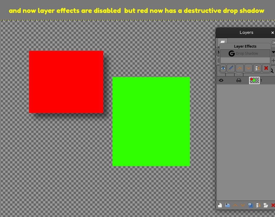

The bug stated in post above sometimes happens but it doesn't always happen

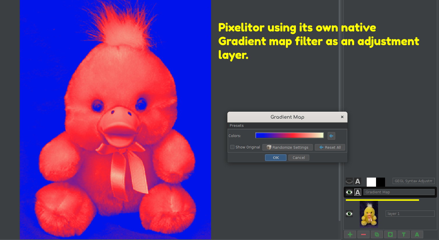

Here is a preview of adjustment layers in an open source program called Pixelitor. You have to enable experimental features to use them but trust me they are stable as I've been using them for almost two years. Pixelitor can also call GEGL from the command line bash and that too can be used as an adjustment layer, but it is very slow and syntax only (for GEGL and GMIC, not native filters, they are fast). In Pixelitor adjustment layers apply something like "gegl graphs" to every layer below them unless blocked out by a "normal layer group".
https://github.com/lbalazscs/Pixelitor
Pixelitor using its Gradient Map filter as an adjustment layer

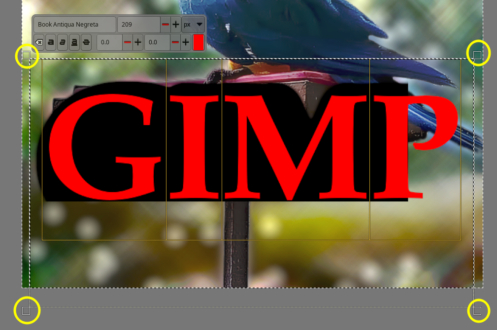

I triggered the out of bounds bug by making a composition with text and dropshadow then moving and expanding the text layer.
Please manipulate the text layers corners in hopes of triggering the out of bounds text bug yourself.
We can solve this bug. I believe in your CMYK Student!

-- Two New bugs caused by the same thing --
Anchoring a floating point with non-destructive filters creates a visual bug on layer with active effects if it is close to it. If the layer is far away enough it won't do that, but eitherway the anchor will double apply and clip the effect, and the original content in the layer will have a destructive effect. The double apply is the effect applying on a destructive layer.
Take the green and red square for example. The red square has always been there as a non-destructive layer. Green is a floating point that is being anchored in the same layer. Now the drop shadow creates a visual clip bug.
Clip bug created by anchoring a floating point on the same layer too close to alpha defined content. I incorrectly used the term "merged"
Drop Shadow applying destructive bug by anchoring a floating point on the same layer with alpha defined content.
anchor_floating_point_destructive_original_dropshadow.png [ 37.89 KiB | Viewed 2354 times ]
The expected behaviour is for both shapes to exist on the same layer, anchoring a floating point should work without the clip or destructive anchor. I hope this bug gets solved. It appears the problem is that anchoring a floating point applies all layer effects when it shouldn't. - UPDATE I did a floating point with select all and it still failed to solve this problem.
