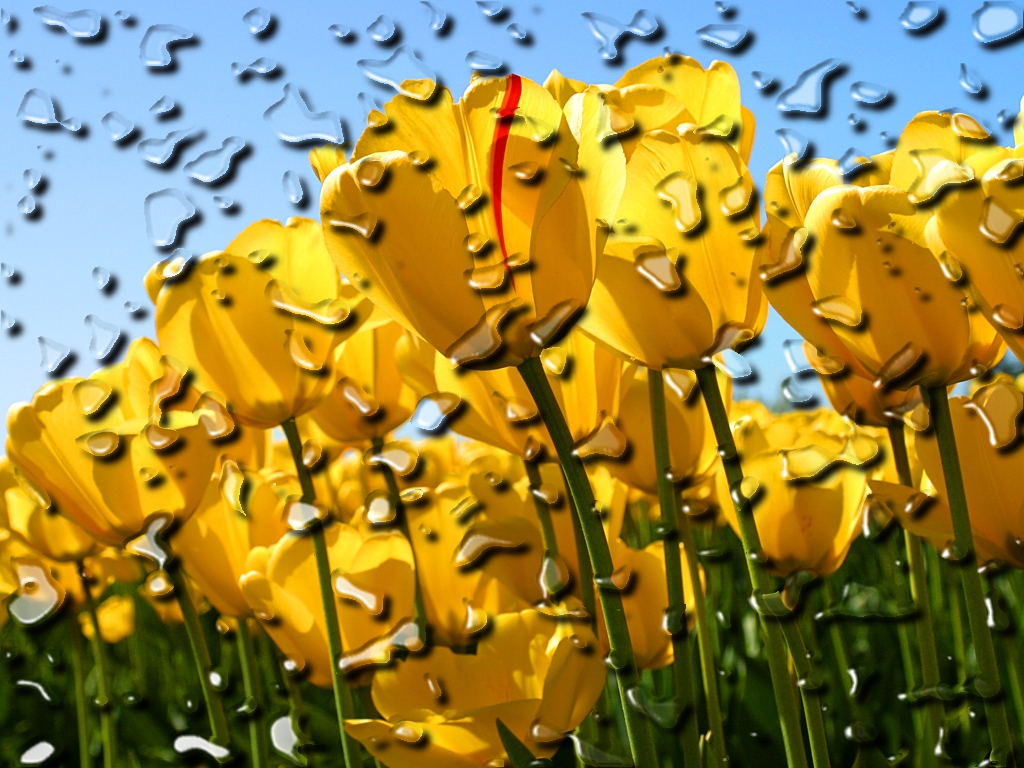

Support link located here Water drops Rel4
but here is a link to a better effort here Learning-GIMP-Create-Water-Drops
 Post subject: Re: challenge for a "realistic waterdrops" script
PostPosted: Fri Jul 18, 2014 1:16 am  (#8)
Thanks!
I'll have a look at both.
PostPosted: Fri Jul 18, 2014 1:29 am  (#9)
Here's an Image done by Molly showing the result of the tutorial
good luck with your endeavor as it is not easy creating Water-drops

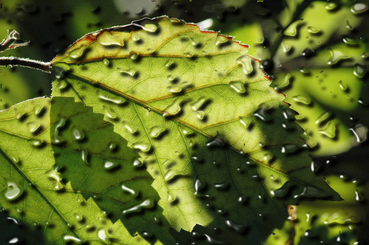

Using the image of the tutorial and your script I got the following result:
not bad at all
the only thing I would like to have in your script, is the possibility to select more spherical drops (as an option in the script, something like: percentage of almost spherical drop=xx)
PostPosted: Fri Jul 18, 2014 2:45 am  (#13)
script works best if you save the layers and adjust the opacity of the shadows, the drops are formed using a technique that prohibits uniform drops, it is more like what you get after a heavy rainstorm has finished

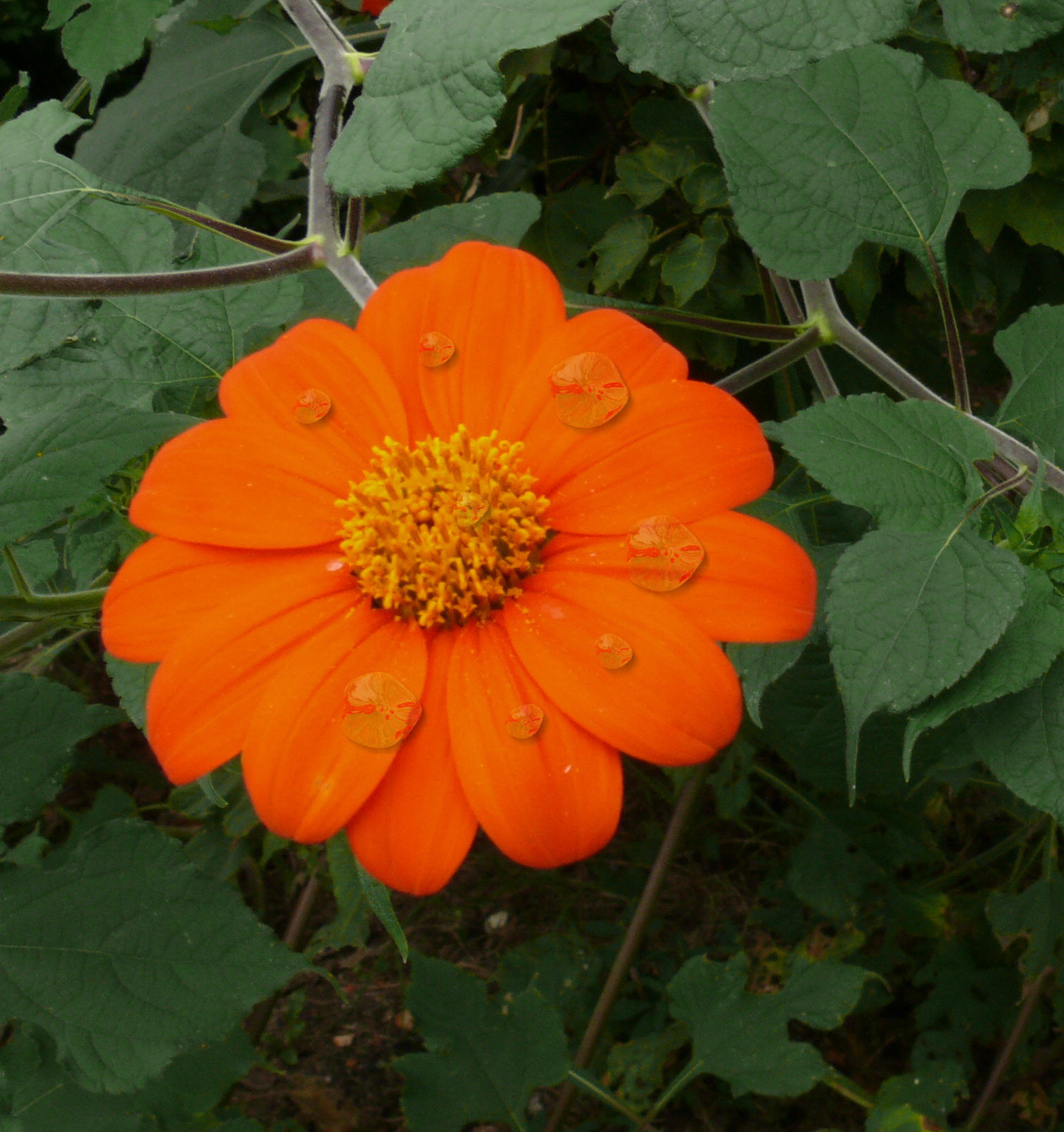

First I created a light-probe map using my entire image (tithonia capture that I took a year ago). I then cropped the image to a single flower and placed random circles on it. I then ran the bevel reflect log script on the dots. I then distorted (wave distortion with large period) on the result. I then displaced the result using the flower as target. I then displace the flower using the drops as target. I then masked the drop with itself to create needed transparency. I then applied drop shadow to the drops making the shadow more pronounced on the flower then the drops (traced the outline of the drops and cut the shadow result from the drops and pasted it on another layer and reduced opacity to taste). Yes, a lot of work and no, this will be the only tut I share. lol

experimenting with Graechan script
here my modifications:
in the script:
1-created and used a pattern noise instead of calling "solid noise" filter
2-set shadow layer mode to grain-extract
when calling the script
3-used as parameters: 80 - 4 - 40
