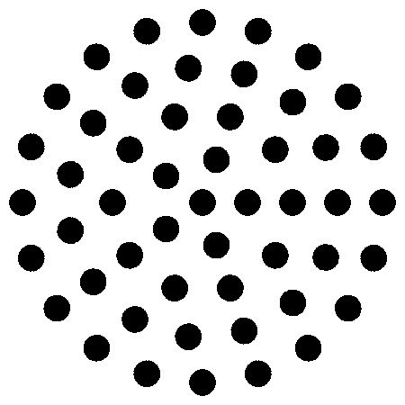

The following patterns were produced using a simple 30px black-filled circle on a transparent background as motif, ring-spacing=40, other settings as default (except radix):
Radix=4: Image Radix=5: Image Radix=6: Image
Radix=7: Image Radix=8: Image

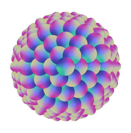

With Radix=6, Rings=5, Ring-spacing=35, Zoom at centre=1.0, Zoom at outer ring=0.5, Zoom-adjust ring-spacing=Yes:
Ditto, but Progressive offset X=6:
With Radix=6, Rings=5, Ring-spacing=30, Zoom at centre=0.5, Zoom at outer ring=1.0, Zoom-adjust ring-spacing=Yes:

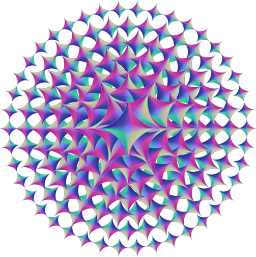

The following patterns were produced using Oregonian's multi-color hypocycloid image (viewtopic.php?f=23&t=11961) as motif:
Radix=6, rings=3, Rotate motifs=Yes, (other settings as default):
Ditto, script iterated:
Ditto, colorized:

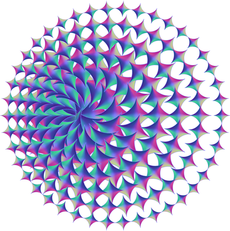

As first above, but Outer rings uppermost=Yes (and seam-mended):
Ditto, iterated:
As first above, but rings=7:

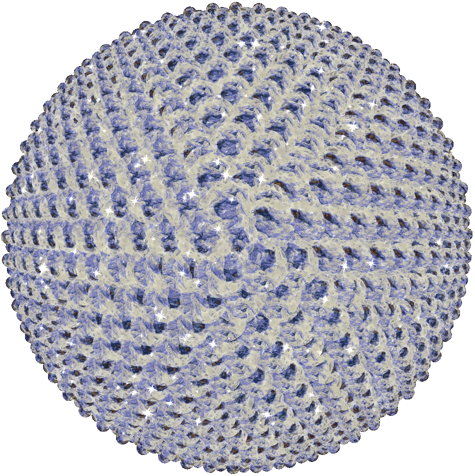

Some other images created with this script:
Image Image Image Image
Image Image Image
Image Image

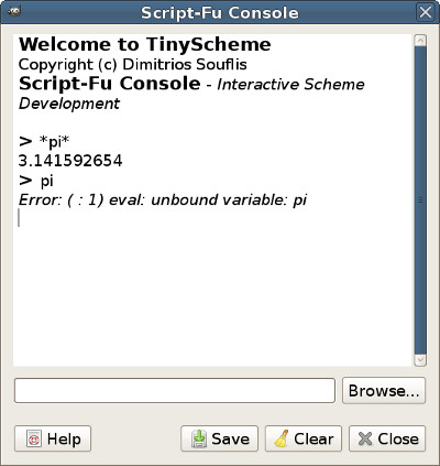

PostPosted: Thu Apr 09, 2015 11:11 pm  (#6)
my image
my settings
my result
my error
JT Replicate in Rings Warning
Error while executing script-fu-JT-replicate-in-rings:
Error: ( : 1) eval: unbound variable: pi
GIMP Warning
Plug-In 'JT Replicate in Rings' left image undo in inconsistent state, closing open undo groups.
 Post subject: Re: Replicate-in-rings
PostPosted: Thu Apr 09, 2015 11:24 pm  (#7)
I forgot to check the errors, here's mine.
Error: (<unknown> : 154194524) eval: unbound variable: pi
GIMP Warning
PostPosted: Thu Apr 09, 2015 11:40 pm  (#8)
Joined: Dec 27, 2014
Posts: 508
Okay, sorry about that folks.
Both "pi" and "*pi*" are defined on my systems, i don't know why they're not on yours.
Anyway, I've changed the script to use a built-in definition.
Please delete the first copy of the script, download again from my first post and try again.
Cheers.
