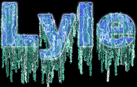

Using the "logo" function:

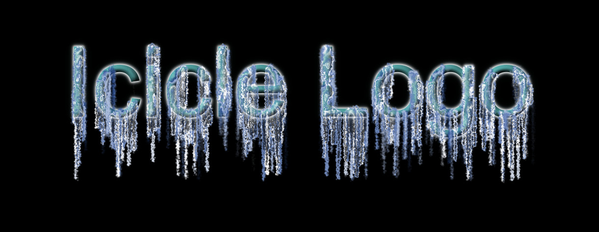

I loaded also your posted Icicle and it works without any change.
I guess this is due to the fact that I'm using Samj's pack, which probably starts Gimp activating the "compatibility" mode.
But IMO it looks like a duplication of Icefire, relative to the "Ice" option.

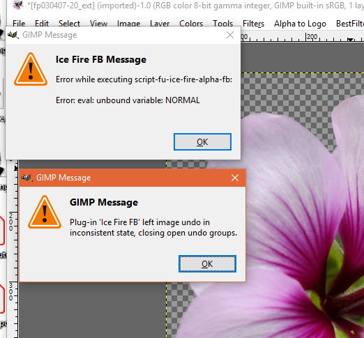

Unfortunately, I get the same type error, Diego (yes; removed the original script-fus per your request), so it's more than just a naming issue. Very strange. :)

I found that Tin's program did not translate the "NORMAL", done manually
try this one

Yes, Diego; tried them both before. Now I tried your update and this time get another error (progress). Both Icicle and Ice Fire gives the error below (and leaves a selection {aka, dotted lines}). I did click off the layer error box before taking screenshot. :)
