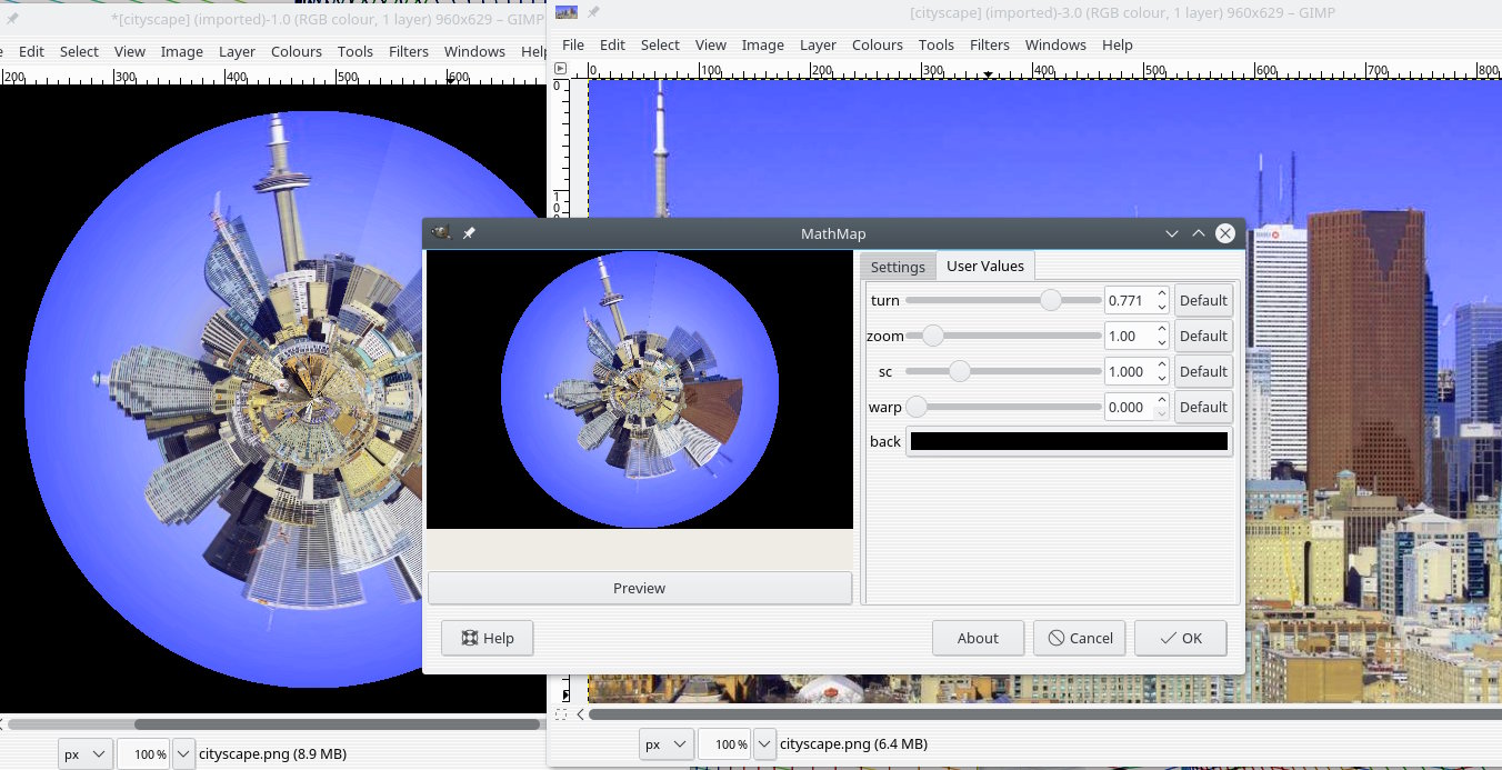

Not so much a recommendation as a possibility. The old MathMap plugin -> miniplanet filter

Mmm...
I do not see the "MathMap" directory, neither the "miniplanet" filter.
The closest I got to that was "Map" directory, the "Little Planet" filter.
But it seems the results from kuula.co are considerably better :(
I did notice a filter to make Panorama Projection, in the same directory. But I am not sure this is what I need.
Maybe I'll just stick to the Little Planet filter...
Thank you rich2005 :)

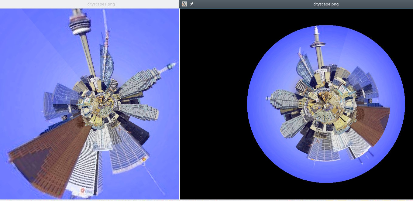

I am always vary wary about this-is-better than that. All in the eye of the beholder. I would hang on and wait for more input from forum members. There might be something better.
A comparison. Strange that one is clockwise the other anti-clockwise.
