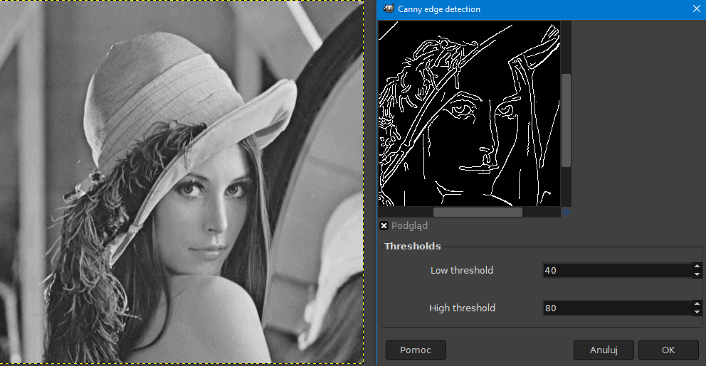

PostPosted: Thu Feb 13, 2020 4:55 am  (#1)
Author: David Mládek
Licensed under the GPLv3.
Advanced edge detection - GIMP plugin implementing Canny filter for edge searching.
Download source: https://github.com/mladedav/canny-edge- ... imp-plugin
In menu GIMP: Filters/Edge-Detect/Canny edge detection
From the documentation (translation from Czech to English using Google translate):
The plugin works on grayscale images, but can convert both RGB and INDEXED images to GRAY alone, and then perform its function.
The plugin is not yet able to work with images that have an alpha channel.
The plugin can interact interactively by filling in the "High Threshold" and "Low Threshold" values, which determine how thick edges will eventually remain in the image
(higher values ​​mean less tolerance). The values ​​can be any number from 1 to 255, if the lower threshold is higher than the upper threshold,
the upper threshold will be set to the same value as the lower threshold. Any values ​​entered should not cause unexpected behavior or failure. Preview is also available in interactive mode.
It can also work non-interactively, where five parameters are passed, and the last two are the same as in interactive mode. Again, the same values ​​are expected,
but they are not checked, and anyone who creates scripts with non-interactive calls should know the calling convention and restrictions in advance.
Nidhogg pointed to the possibility of using Canne in the thread about the Kirlian effect. Thanks for the solution.
viewtopic.php?f=11&t=18002&p=247339#p247336
Lylejk requested a version for Windows - so I compiled (32/64 bit for Gimp 2.10.14)
Edit 14-02-2020
Attention.
The 64bit version does not work properly (there is a problem with scroll bars and enlarging the window size for the preview) - sorry but I don't know why.
Canny-edge-detection-Win 32_64bit Gimp2.10.zip [272.13 KiB]
Downloaded 779 times

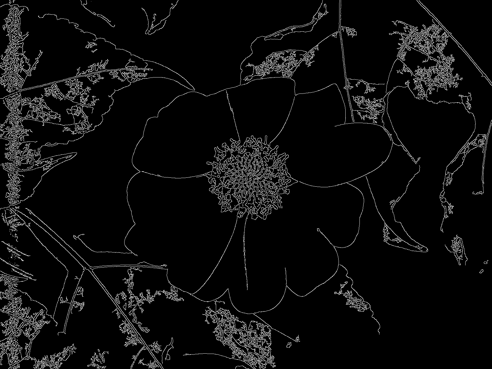

Posts: 12855
Thanks, Mario. Works great. This one's on the tithonia capture I did a few years back. Have to experiment more, but am quite impressed and see its application for masks (which I need for other things such as mosaics). :)

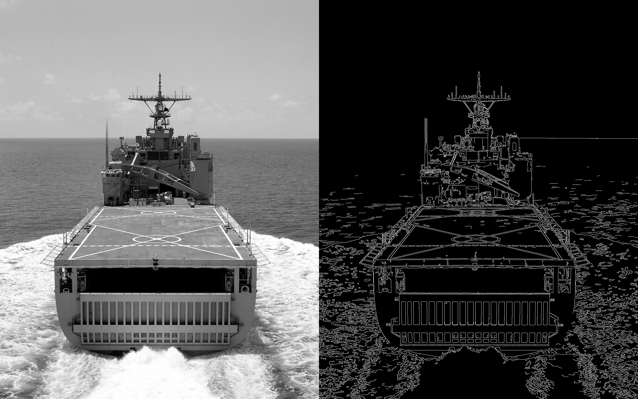

Quite good given the image. Just wondering why it missed half the horizon while at the same time detecting the edges of the wake.
 Post subject: Re: Canny Edge Detection Gimp 2.10 Win10 32/64 bit.
PostPosted: Thu Feb 13, 2020 2:07 pm  (#5)
Posts: 1443
Because you didn't play with the threshold. Low threshold 53, high threshold 63.

Nidhogg wrote:
Ah, nice....
