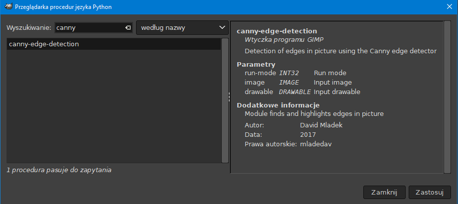

For the test, I rebuilt the new msys2 environment with Gimp 2.10.15 and compiled Canny. This did not solve the problem.
I wanted to try the option of using Canny in the Diego's Filling scripts plugin - I looked at PDB canny ... and was surprised.
I'm not an coder but it's easy to see that there are errors in the code.
Following only logic I tried to fix it.
For brave testers Ver.0.2
Canny-edge-detection V-0.2-Win 32_64bit Gimp2.10.zip [279.96 KiB]
Downloaded 363 times
