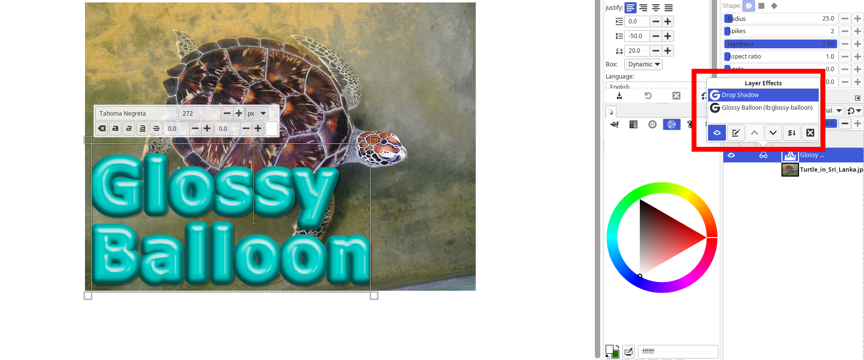

I built CMYK Student's Gimp 2.99.17 from source today and now I am testing non-destructive GEGL filters. Let me just say that it is AMAZING and I ADORE every second of this, but I still found some bugs. I will be posting in this thread to show off the non-destructive editing potential in CMYK Student's special build of Gimp 2.99.17. It works with my plugins obviously.
My Plugin Glossy Balloon and Drop Shadow in Gimp 2.99.17 non destructive.

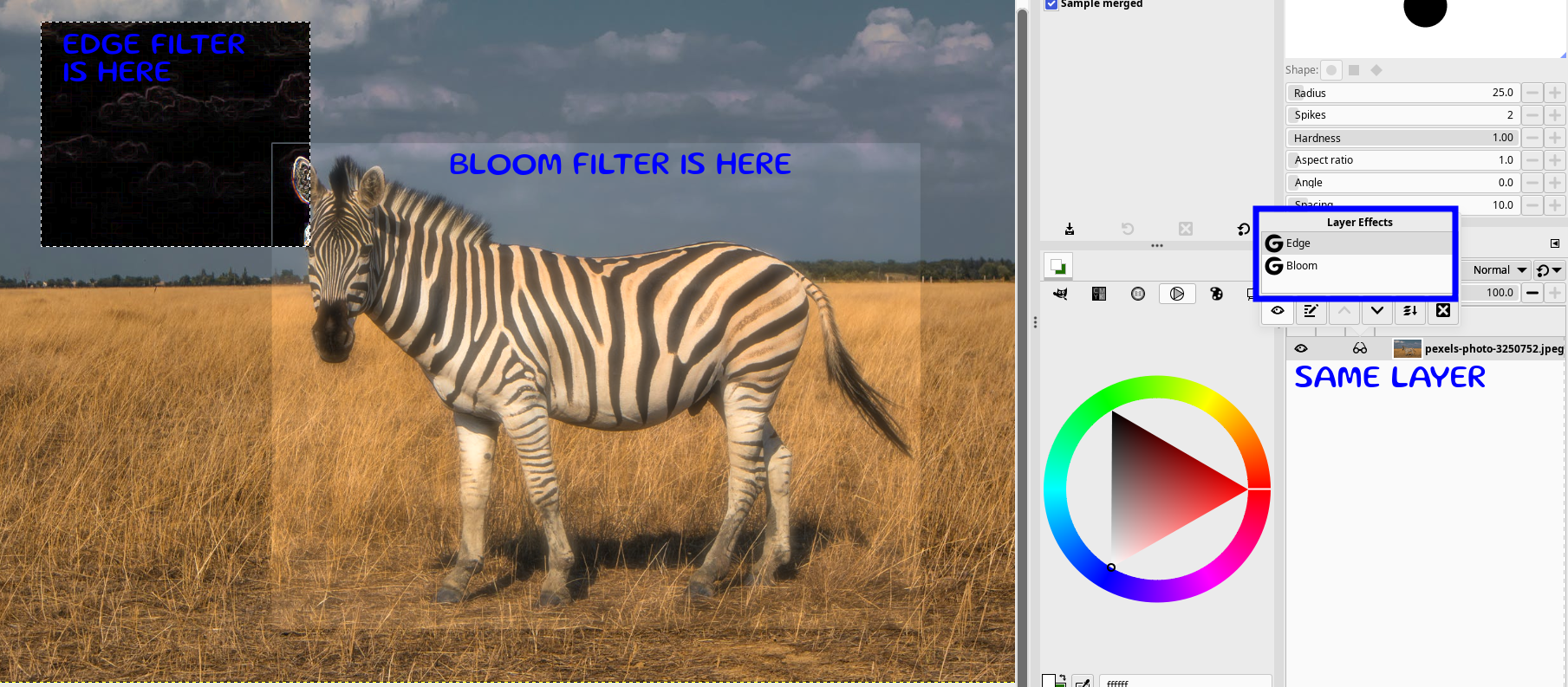

The rectangle select tool and other tools like it can make selections and then we can apply GEGL filters non-destructively, but what is very impressive is that GEGL remembers where the selection is applied.
In this picture the Edge Detect filter (Edge) and a orton glow filter (Bloom) are both on the same layer and selections
that were made with Gimp's Rectangle Select tool are remembered.

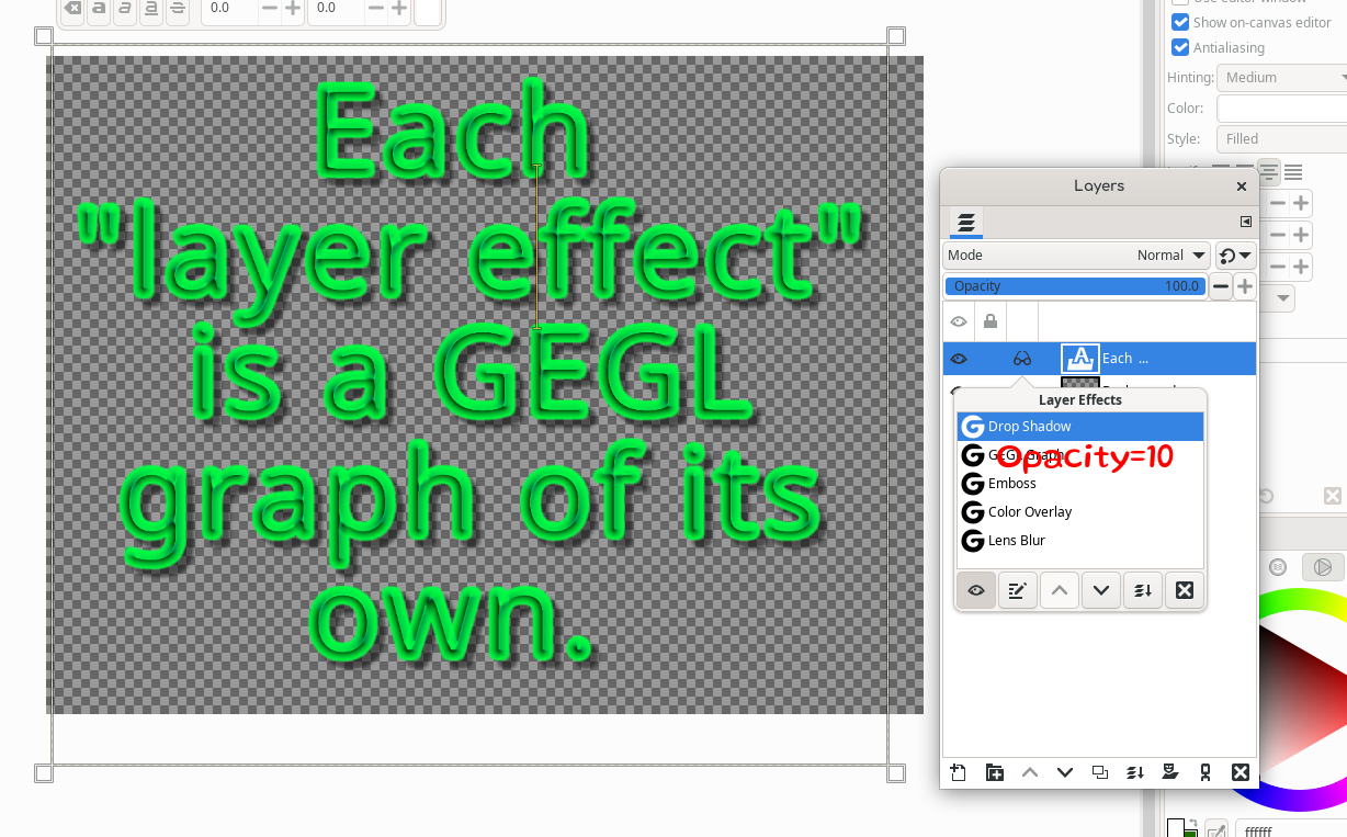

It is interesting how Gimp's team made non-destructive editing in Gimp 2.99.17. The usual glitches that exist in Gimp's GEGL Graph are not present here.
Let me explain what is going on. In a nutshell each "layer effect" or "smart filter" whatever you want to call it is a GEGL graph of its own. Here is a pic of all the effects.
This text style can be written in GEGL syntax the usual way I do it like with a median-blur radius=0 to reset the GEGL graph from bugs.
gaussian-blur std-dev-x=3 std-dev-y=3
color-overlay value=green
id=1  gimp:layer-mode layer-mode=grain-merge aux=[ ref=1 emboss  ]
opacity value=10
dropshadow x=0 y=0 opacity=0.9 color=black
But this is how Gimp's team does it in non-destructive editing. They use a way to separate graphs entirely.
gegl:gegl string=" gaussian-blur std-dev-x=3 std-dev-y=3 "
separator
gegl:gegl string=" color-overlay value=green "
separator
gegl:gegl string=" id=1  gimp:layer-mode layer-mode=grain-merge aux=[ ref=1 emboss  ]"
seperator
gegl:gegl string=" opacity value=10 "
seperator
gegl:gegl string=" dropshadow x=0 y=0 opacity=0.9 color=black"

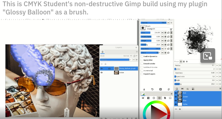

Here is a video of my plugin "glossy balloon" being used as a brush.
https://www.reddit.com/r/GIMP/comments/ ... imp_build/
Download to Glossy Balloon is here but note it is destructive in Gimp 2.10 and normal 2.99
https://github.com/LinuxBeaver/GEGL-glo ... xt-styling

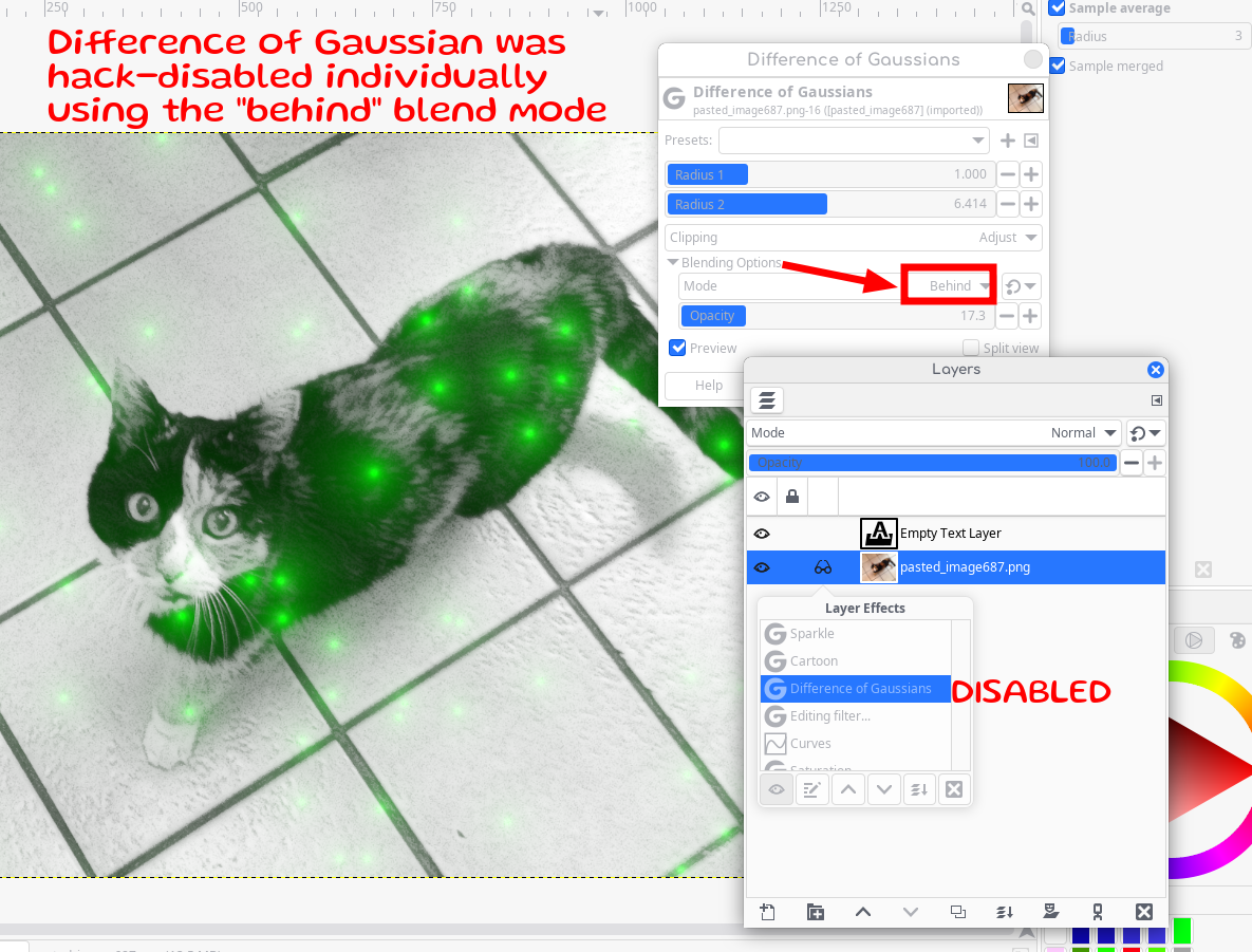

Filters cannot be individually disabled yet, but they can be "hack-disabled" by setting them to the behind blend mode.
I guess this won't work on images with transparency and filters that generate rendered fills (like cell noise and spiral). In that case set their opacity to 0.

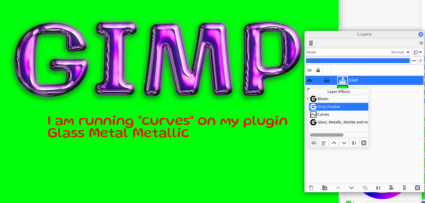

Here is my plugin "Glass Metallic Marble" being ran with curves on top of it. Curves cannot be ran inside GEGL Graph so this is an interesting thing I have going on.
