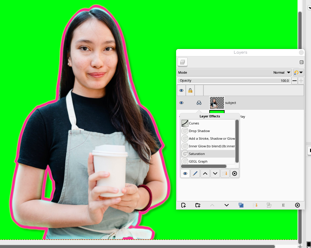

The same "layer effects" from this image were applied to two other images by selecting and deleting the coffee girl and merging a floating point on the layer she was on.
These two images below take the "layer effects" that were on the girl.

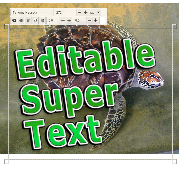

ok, I just confirmed that my bash plugin that can call AI and GMIC filters does not allow editable text with CMYK Student's build. If you try to edit the text it shows the text box but no matter what you type nothing happens. It only shows the original text that the filter was applied on. The reason why this happens is obvious, because the text is an imported png from GMIC or whatever other app outside of Gimp. GEGL text is editable because GEGL is actively running on the text layer. The imported bash command is just GEGL importing a png from the /tmp/ folder.
