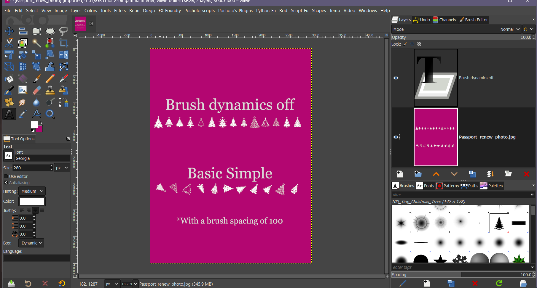

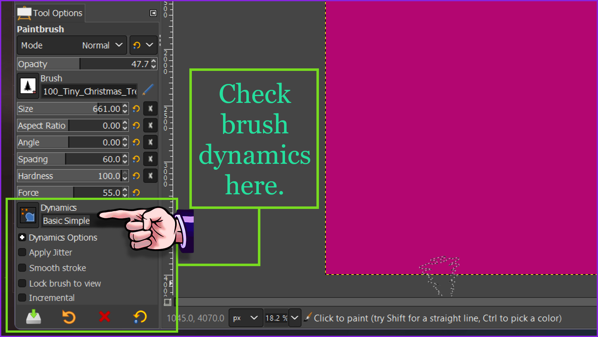

This could be a "brush dynamics" issue?
Access the "Brush Dynamics" settings within your chosen paint tool,
and then ensure there are no options selected.
If the "Basic Simple" brush dynamics option is selected,
this will rotate the brush.

thank you it working good now.
