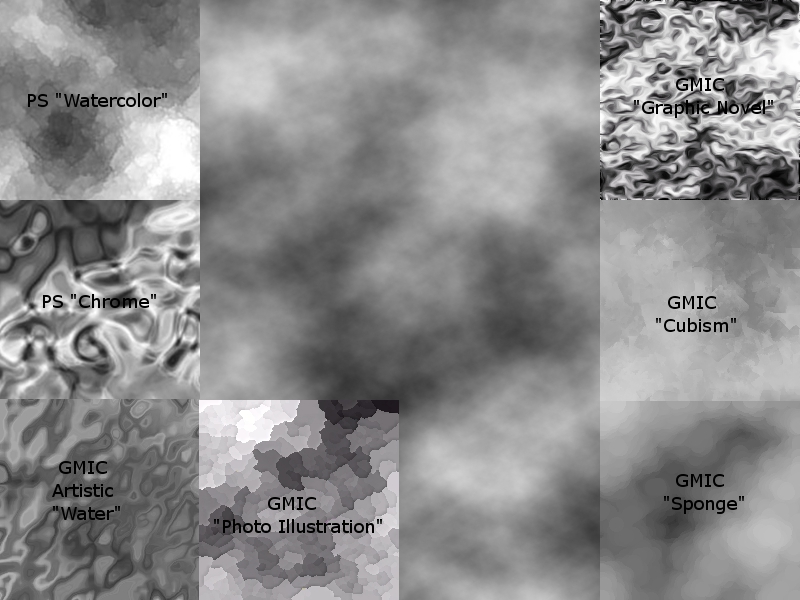

There are a couple of filters in Photoshop that I would like to immulate and can't seem to come up with the right combination.
First they render some clouds.
Second they apply the "watercolor" filter. (Gimp's watercolor filter looks like black worms)
Third they apply the "chrome" filter.
Anybody want to try and recreate this effect? Lyle? Mahvin? Anyone? I've tried every filter and combination I can think of that comes close and I just can't get there.

For 'chrome' I used a greyscale image with a white background and a selection,(no alpha channel), go to Filters-Decor-Stencil_chrome,for this image, I used a selection from wilbur.
 Post subject: Re: Filter Effects
PostPosted: Thu Nov 10, 2011 9:33 pm  (#6)
For PS Chrome, the closest I could get was using Difference Clouds (Turbulent) x and y at 2 each, then run G'MIC water filter and adjust amplitude, etc..
I'm sure with more testing you could get it even closer to the PS effect. I notice that in PS the difference clouds are spread out a great deal more than they are in GIMP, which could be the reason the outcome is so different.

That's pretty close for the chrome Mahvin. Maybe a curves/contrast adjustment to get the highlights to stand out more like in the PS example. It almost looks like a combination of the "Graphic Novel" filter and the two you used.
I found the link to the last one I was fooling around with. It's pretty long and the steps I am referring to are quite a ways down in the tut where they start decorating the top text layer.
http://textuts.com/3d-skyscraper-text-e ... s5-part-1/
The watercolor example really throws me. Surely there is a gmic solution. If not, we could definitely use a new filter that would do it.

The closest I could get with the watercolor effect involved using Gentlemanbeggar's bokeh blur and the sponge filter in G'MIC. But it wasn't close enough for me to think of sharing the result.

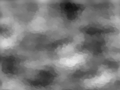

The following was done with GIMPressionist. Is it close to the watercolor effect?
I was going to mention GIMPressionist. The most overlooked, undervalued and misunderstood plugin in Gimp...

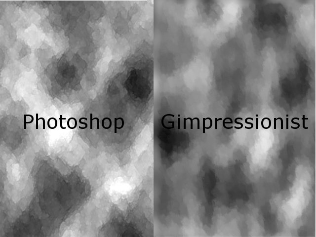

Looks a lot closer than what I came up with. Mind sharing a screenshot of the settings you used? Here they are side by side.
I tend to agree Mahvin. Now that we've sort of beat this horse to death, you guys did come up with closer results. I admit I never did try the Gimpressionist filter. I was working backwards with the chrome going with watercolor first then metalic look instead of vice versa. Thanks everyone!
