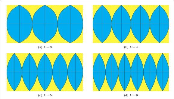

I understand what you are asking but I don't know how it is possible. Perhaps someone else can help you. It would involve sphere sections and and spherical trigonometry or calculus. Then mapping it. Oh, my. The ornament is only one sided, to get it to be 3D would be very difficult.
I doubt you can use the output from Graechan's script - you would at least need two to go around an ornament. You need to use a rectangle with all of the elements on it. Getting it the size of an ornament would be difficult, too.
Here is an image I found in a pdf document.
Here is a link to the pdf document.
http://erikdemaine.org/papers/SphereWra ... /paper.pdf

Yes, that is the type of thing that I am looking for.

I cleaned out the bg from the 4-sectioned one and made a square for the ornament that was half the width of it. Duplicated the layer, re-sized the canvas so it was twice as wide for the ornament and moved one of the copies to the right so I had a wide rectangle with both ornament squares in it.
I overlayed the sphere, did alpha to selection, inverted the selection and deleted.
I made it very plain but you can see what needs to be done. I also have attached an xcf file with the layers intact.
