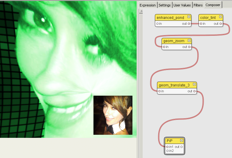

Wanted a super quick way of insetting a snapshot of the original image before it goes through the filter chain. So here's the filter for just that, you just drag PiP into composer wire the output of the filters to it and you get this..
I've written it as a utility filter but it does have sliders so if you want to get creative with it and post the results be my guest! It honours transparency from the input images and you can scale the inset to be larger than the original if you want so have fun. Just as a lame example..

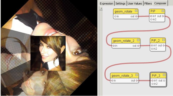

OK an example using an image from a Gimp layer and applying a rotate transform prior to PiP in composer. (Notice the transparency on the inset).
