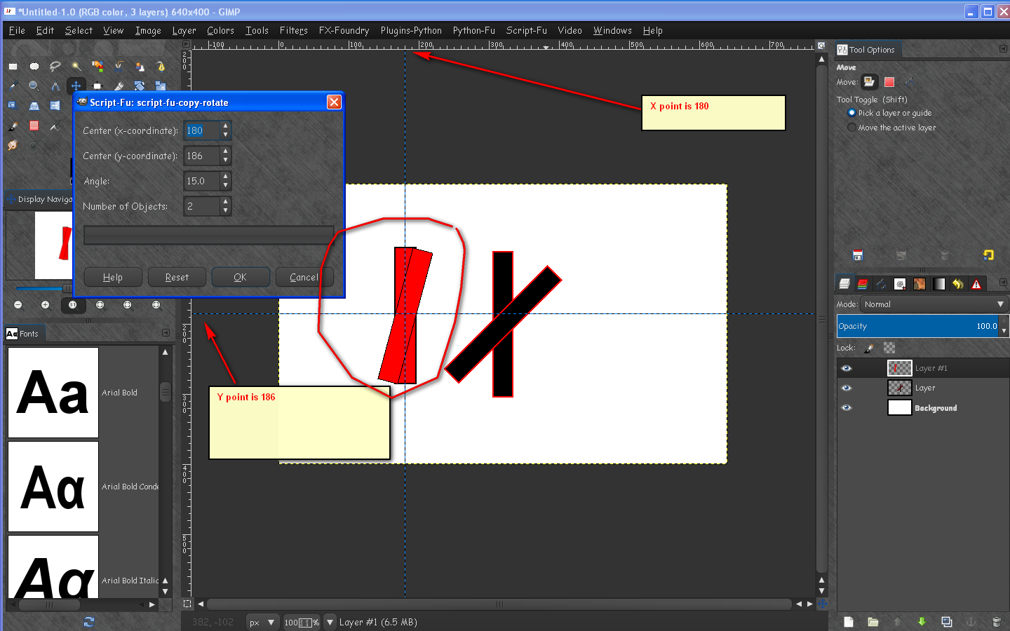

Define the center of rotation, angle and count it will then copy and rotate based on the original distance from center. I have included images to show usage. This was based in part on Radial Copy by pkotronis but as i couldn't figure out how to use his i made a simpler one
this is what happens when i enter x:300; y:200; 90 degrees; number of Objects: 2

 Post subject: Re: 'script-fu-copy-rotate'
PostPosted: Tue Jul 31, 2012 6:47 pm  (#2)
The problem in full.

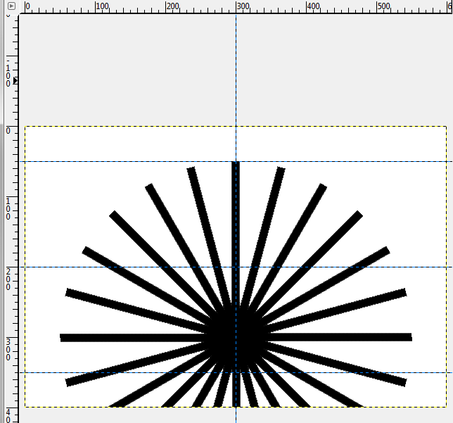

yeah, you get a nice "sun" when you enter the following numbers
x:300; y:200; d:15°; NoO:24
for some reason the script uses 300/300 as the centre of rotation, instead of 300/200

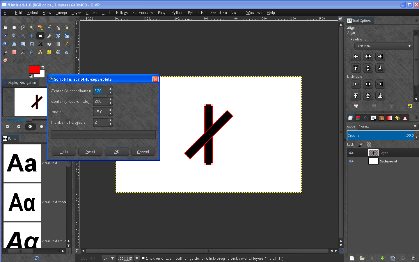

That seems like a cryptical response frome Erisian. How does it work with square images?
it works as its supposed to....maybe this script needs a square canvas

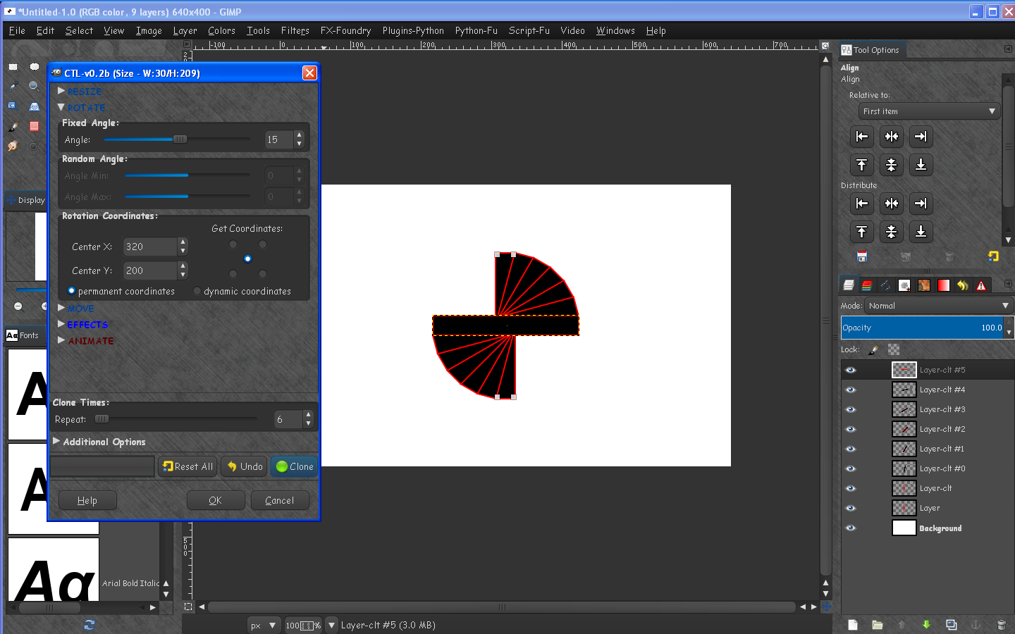

A much better tool is the clone-layer-tool
http://registry.gimp.org/node/25422

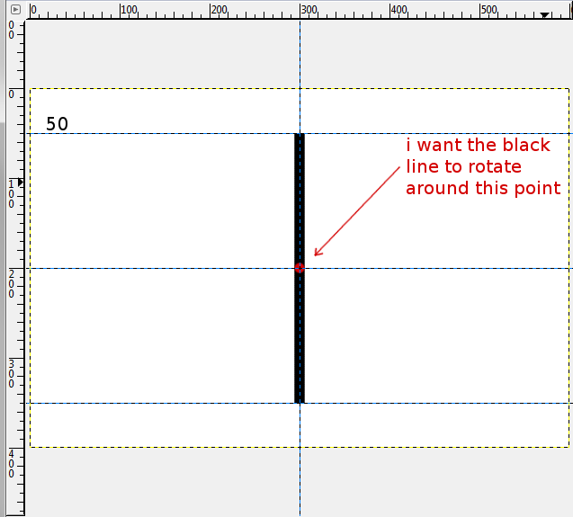

I fixed the script so it rotates exactly in center now.

But you will have to determine the exact center of your selection with guides.
For example

Also you may want to have a look at this linked thread below.
Script/Plugin That Emulates Mura Meister Copies
This is a new script (Mura_Meister_Copies.scm),
created by Gimp Chat member trandoductin.
Offers better options then the original,
or most recent version of script-fu copy-rotate.
