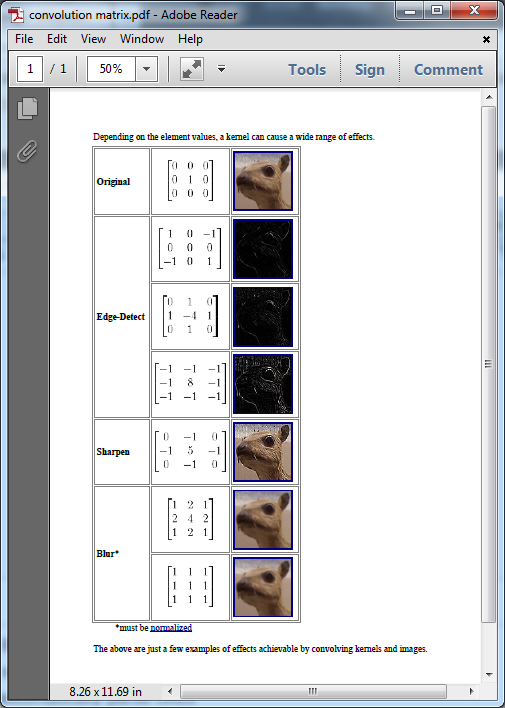

I found more info on the web than what was in the gimp docs
