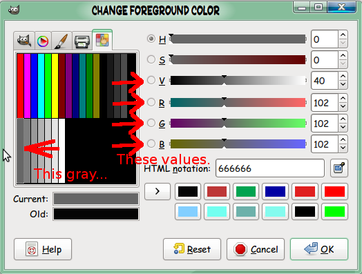

If you want to see what the color is numerically, you could use the eyedropper tool :colpick to "get a sample" of the color. This will load the sample color into the foreground color box; then click on the foreground color box and it will show you the numbers being used to represent the color as either RGB, HSV, etc. To produce various shades of gray, RGB color modes output equal amounts of each color channel; the lightness or darkness intensity can be finely controlled by the Value. if there are variations among the RGB channels then the color is not a gray shade.
In this image the medium gray is RGB:102,102,102 with an intensity Value of 40; if it were an "off" color then the Red, Green, and Blue channels would not have the same number for each.

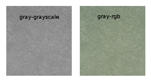

So, are we saying that in a perfect world that a scan of a b&w image will look the same in rgb or grayscale?
Anyhoo, here is a comparison of scans from a photographic graycard, in grayscale and rgb.
The same image being scanned using both methods (color and greyscale) resulting in the same appearance? No.
A color scan of a B/W image or negative will leave a color tint of one or more of red, green, or blue. This depends on how good the sensor and lamp is, whether its calibrated to the best of its ability, etc. My old crappy HP negative scanner leaves all three colors behind. My accountant actually requires me to send her colored scans of my b/w documents in pdf format, and I can see light hues of red, green, and blue all over them. Would I get the same result from a higher end scanner? Probably not. I really don't know the answer to that, just too many variables in play.
