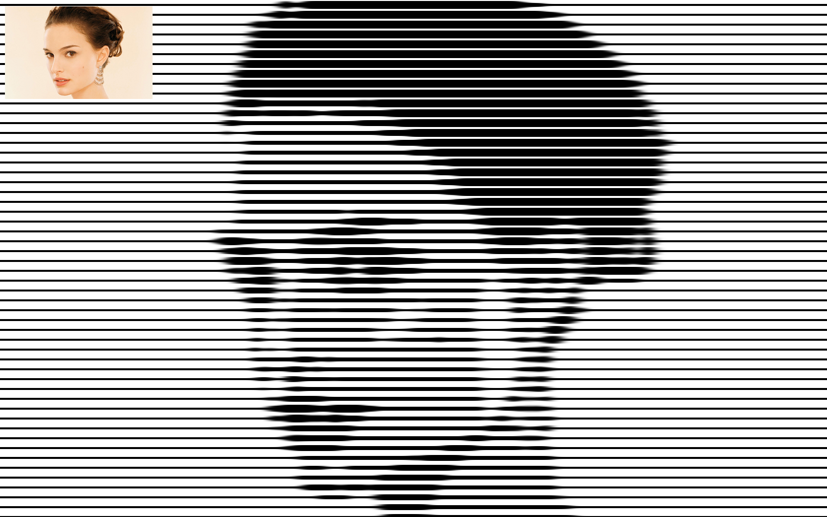

I have a method for this, but it is manual with one layer per required linewidth:
With four levels:
You can cheat and do an anisotropic Gaussian blur:
Not too hard (below, I assume that we want a 20px vertical pattern):
  1. copy image, convert to B&W
  2. Filter/Blur/Pixelize, with 1px horizontal and 20px vertical
  3. While this image is displayed, go to the Channels list and copy one of the RGB channels
  4. Using filter/render/grid, generate N layers of horizontal lines on opaque background with:
    • Spacing = 20 (the pattern width)
    • Offset=10 (half the pattern width)
    • Thickess=4/8/12/16pixels (visually, 20%, 40%,60%,80% of black on white)
  5. Make sure these layers are ordered with the thinner lines on top.
  6. Add a layer mask to all layers except the bottom one, initialize to the channel copy you did
  7. Threshold each of these masks. The 4px (20%) layer will show for everything from 30% , so it's threshold is around 255*.7= 178, the 8px (40%) layer represent everything between 50% black and 30%, so the threshold is 128, and likewise the 12px (60%) layer is around 255*.3=76.

ofnuts wrote:
[*]Add a layer mask to all layers except the bottom one, initialize to the channel copy you did
[*]Threshold each of these masks. The 4px (20%) layer will show for everything from 30% , so it's threshold is around 255*.7= 178, the 8px (40%) layer represent everything between 50% black and 30%, so the threshold is 128, and likewise the 12px (60%) layer is around 255*.3=76.[/list]

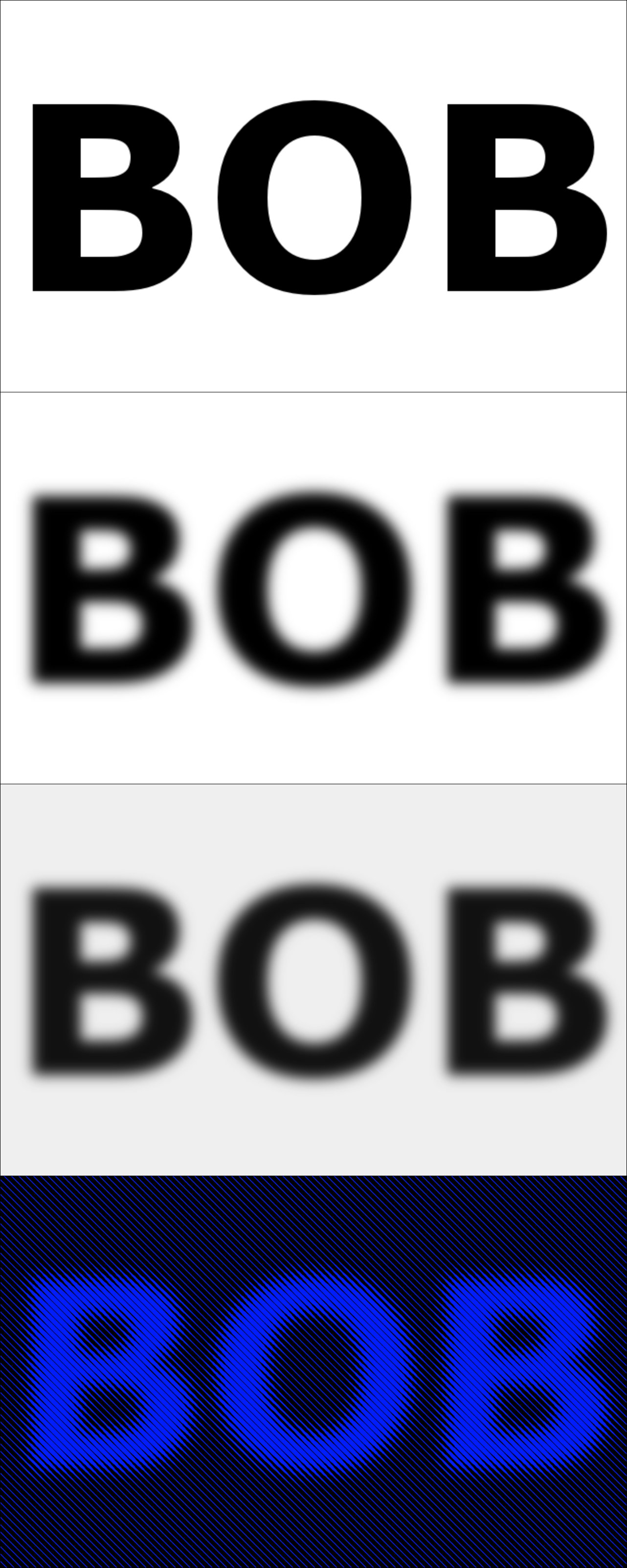

You can use my greyscale dither script:
http://silent9.com/incoming/scripts/gre ... dither.scm
It does work best if you enlarge the image first. The larger you pre-blur, the more gradual the lines widen.
This sample I used map black to blue and white to black (in the script options) and picked the greyscale compensated selection.
Here is the dither pattern I created for this:
pattern.png [ 449 Bytes | Viewed 7225 times ]
You can get many more greyscale ditherhalftone patterns that can be used from here: http://gimpstuff.org/content/show.php/d ... tent=81817
-Rob A>

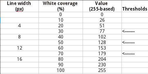

Might be easier to understand that way, with the thresholds half-way between the white coverage values:
