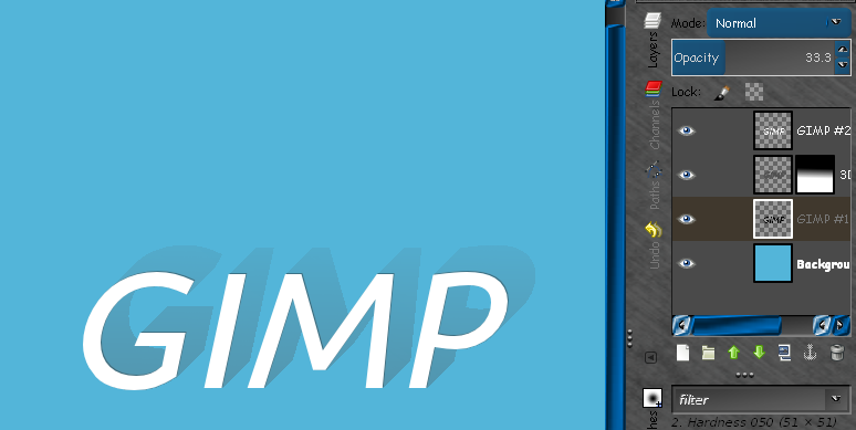

PostPosted: Sun Nov 24, 2013 5:55 am  (#26)
Posts: 16293
This was done with Saulgoodes 3Diffy script and a layer mask of a fg to transparent gradient.
It is indeed a challenge to get that right type of straight edged shadow effect. :)

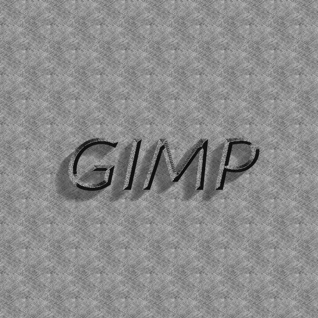

Posts: 16293
I think it looks better with some kind of texture though.

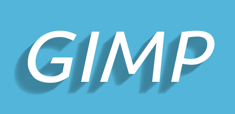

My opinion on motion blur stands. The only but significant drawback here is the shadows from some parts of the letters
extends over the other parts which is not supposed to be happening. Or the shadows not being evenly dispersed.
Image Image
Now compare to this (the same image again)
Seems like only Rod could overcome this problem. Applying black-to-transparent gradient over shadow is a good idea
but would involve a lot of manual editing.
I've tried a different approach. As mentioned earlier, tried ofnuts path-inbetweener script.
The results are promising. In a nutshell, I created two paths from a letter, set one off and ran the script with
15 intermediate paths between them (the more steps - the better results). Then stroke each path on a separate layer.
You can either stroke with the same color and gradually lower the opacity outwards or stroke with fading color (black to
white or whatever bg color is).
As shown in this image
Had no time to actually finish this today but you get the idea.

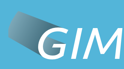

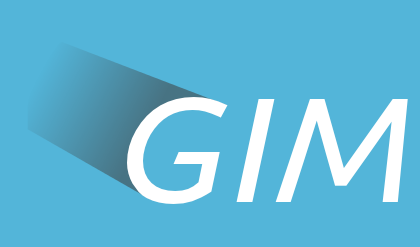

The effects using colour from gradient and the stroke (just make sure the fade length matches the path or the reference circle) can be enhanced by a bit of a curve adjustment to make it pop a bit more:
