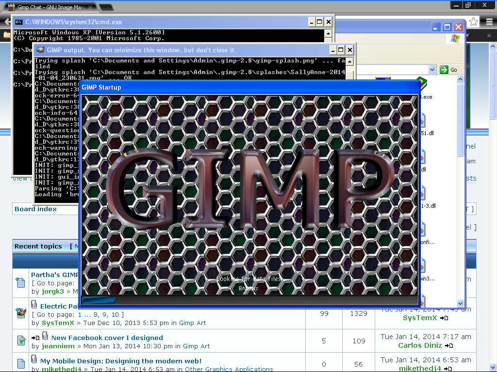

Shouldn't you be starting verbose like this?
cd c:/Program Files/Gimp-2.8-Partha/bin/
gimp-2.8.exe --verbose

Indeed I did (after setting the PATH) correctly.
As I said, it doesn't start. It just crashes.
