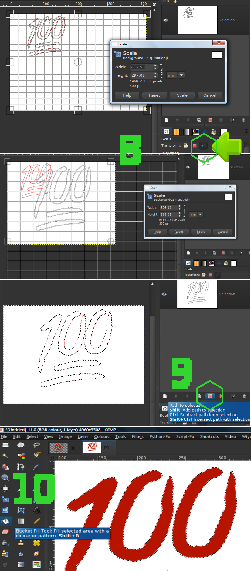

Another method - only with Gimp - in 10 steps.
Simple plug-in Alpha-to-path-interactive.py streamlines the steps 1 to 4.
Alpha-to-path-interactive.zip [1.7 KiB]
Downloaded 111 times

Thanks, good to know (Although the Inkscape method I think I'll go with...)
 Post subject: Re: Anyone know a way to improve this image so that I can make it larg
