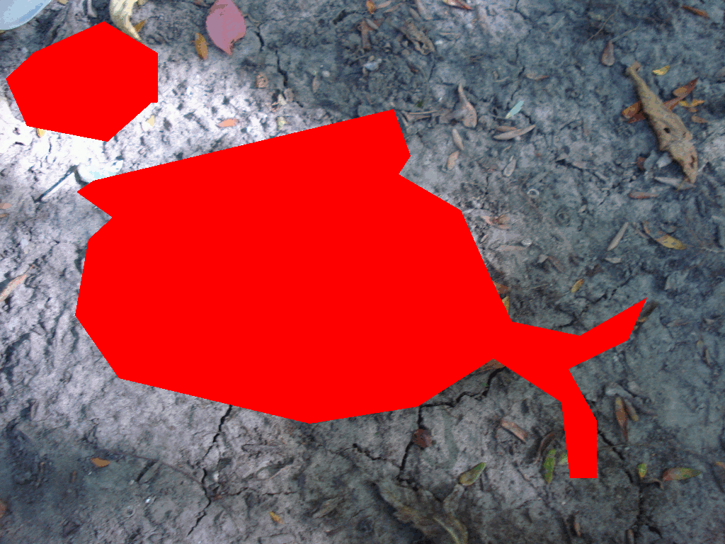

@ O & Molly,
Someone on the GMIC site had a problem with edges of the mask remaining. Their solution was to turn off brush dynamics. Hope this helps.

Problem ?.

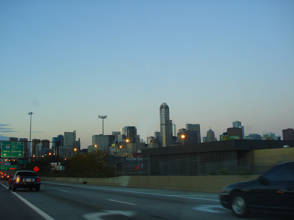

Really amazed at this feature. Removed the Sears Tower in Chicago:

This filter can do amazing things, but the difficulty is to find the best parameters.
Here is what I get with your image, Warrior :
I've chosen a bigger patch size (38!) than the default (7), in order to make the reconstructed texture more coherent.
Very nice! I was reading a small tut last night, that said, "As I understand it from David, the Patch size parameter adjusts the size of the area that will be copied from the surrounding texture to place into the region. The Lookup size adjusts how far away from the inpaint region to look for new textures (similar to “sampling width” in Resynthesizer), and the Blend size adjusts how big of a blend to allow when patching." I was testing on the building removal based on this. It did take some testing, but really enjoy the process. I didn't do any screen shots of the red I applied, but here's the parameters I used to take the building out:

pirate541 wrote:
I am sorry
With all the different answers,I still can't get it to work.
Is it possible to have it detailed a bit ,please?
I created a layer over the original, and used the pencil, in red, the default mask color, and colored over the section I wanted to take out. Merged the layer into the original, and ran the inpaint patch based.

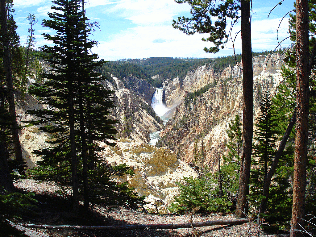

Inpainting is really cool. Here's a shot of Lower Falls I took from Artist's Point, in Yellowstone:
Removed the falls, and river:
Animation:
