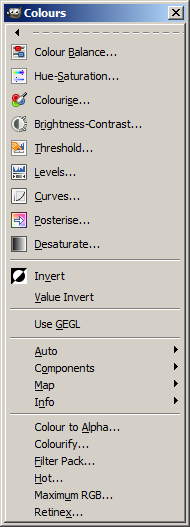

I guess you're asking this in general terms rather than GIMP specific menus, where you can use the "tear-offs" to get separate windows when accessing the menus from the right-click(context) menu:

Yes, I want to screen capture all drop downs, but realize it is not possible without capturing the whole window.
I had to use my iPad to take a picture yesterday of the gradient drop down I posted yesterday, then download to the thread.
