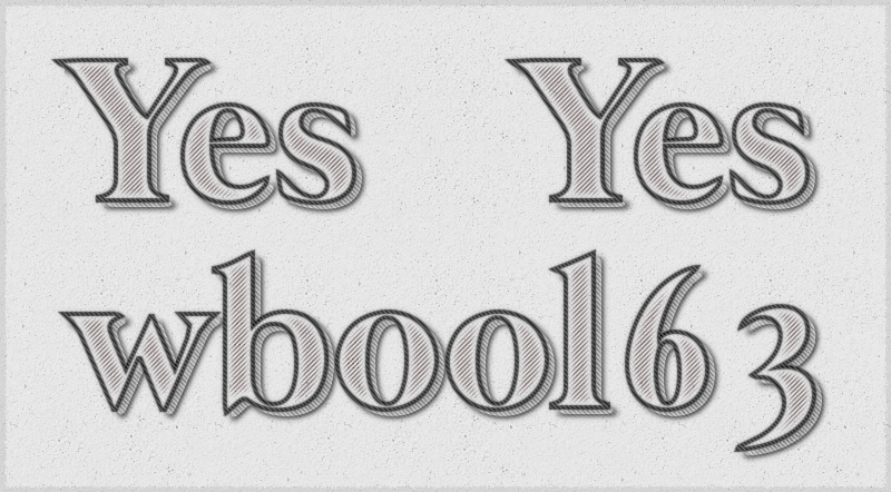

 Post subject: Re: Hatched Fonts
PostPosted: Fri Apr 11, 2014 10:25 am  (#8)
Posts: 14217
Perhaps this one may be a little better. Please, your opinion would be appreciated. :roll:
PostPosted: Fri Apr 11, 2014 10:31 am  (#9)
Posts: 14250
Nice tutorial and an even better use of the blend tool. :bigthup

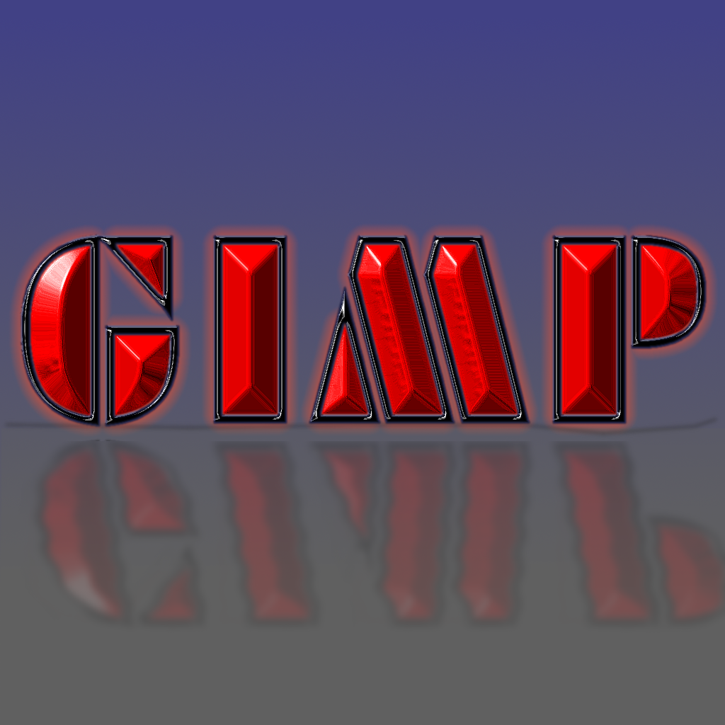

Great tut WBool63, lots of ways to go with this idea. Here's my go at it.

Kellyman, your outcome is great! I love the colour of the your text. :yes
Kellyman , You have certainly taken it beyond the tut, It looks like recessed glass letters in a colourful wire frame. Very nice
Wbool

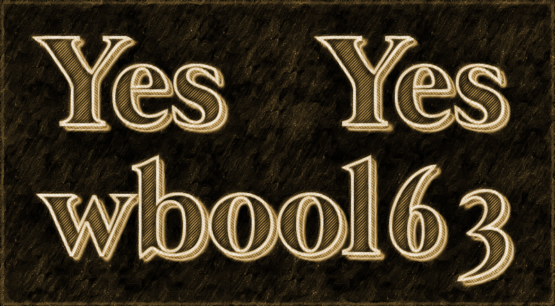

Wbool
Thanks Wbool63 :jumpclap this is another variation I threw together.
