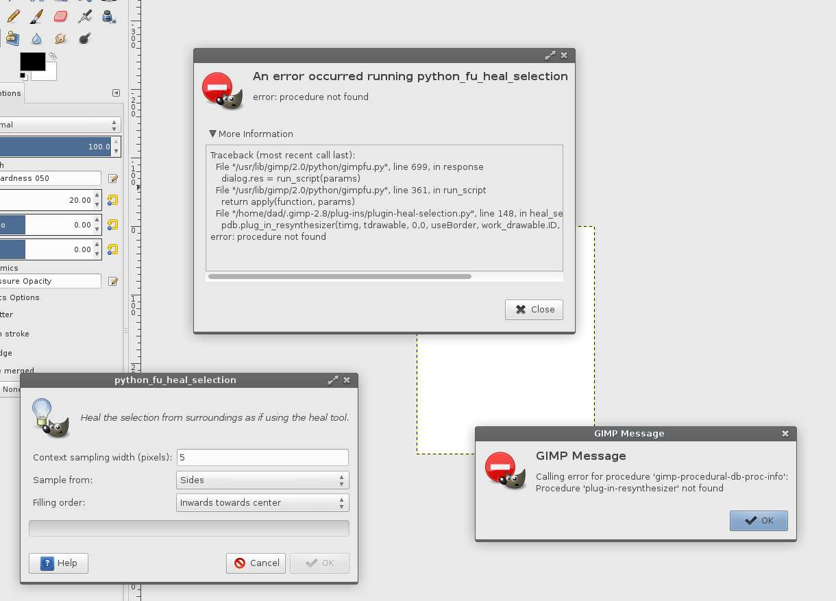

/plugin-heal-selection.py
Calling error for procedure 'gimp-procedural-db-proc-info':
Procedure 'plug-in-resynthesizer' not found
-and-
Traceback (most recent call last):
File "/usr/lib/gimp/2.0/python/gimpfu.py", line 699, in response
dialog.res = run_script(params)
File "/usr/lib/gimp/2.0/python/gimpfu.py", line 361, in run_script
return apply(function, params)
File "/home/dad/.gimp-2.8/plug-ins/plugin-heal-selection.py", line 148, in heal_selection
pdb.plug_in_resynthesizer(timg, tdrawable, 0,0, useBorder, work_drawable.ID, -1, -1, 0.0, 0.117, 16, 500)
error: procedure not found
Been trying to remove some text from a photograph and resynthesizer seems like the tool I need. But I can't, for the life of me, get it to work without crashing.
1. I run gimp as normal.
2. Load picture.
3. "Lasso" the selection.
4. Choose Filters>Enhance>Heal Selection
5. Set the settings in the dialog box that comes up.
6. BAM! It crashes like a big dog.
I've tried re-installing GIMP, the plugins, rebooting, everything I can think of!
I've seen other folks having similar problems, but I don't see how anyone has been able to help.
Anybody seen this problem, or, more importantly, it's solution?
Thanks!
HJ :O)

It looks like you don't have the resynthesizer Plugin installed you should have all these files in you plugin directory, especially the 2
I have outlined
 Post subject: Re: Plug-in resynthesizer throws "error: procedure not found"
PostPosted: Sat May 24, 2014 7:58 am  (#6)
Joined: May 23, 2014
Posts: 2
That's what I thought at first. Either I didn't have them or I had them with the wrong permissions. But this "ls -l" indicates that I do have them and they are in the right place.
Thanks for your quick response!
HJ
