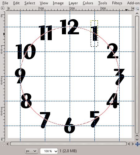

Actually there are two other ways to mark where the numbers should go, using stock Gimp:
The Gimper way:
1) Making a selection/Circle path for the circle
2) Since the number are at 30° angles, use "constrained angles" to draw lines from the center to the circle, the number being positioned at the end of the line.
The geometrician way:
- Number 4 hours part (for instance 12->4->8) are on an equilateral triangle
- In an equilateral triangle, the center of the circumcircle splits the height 1/3,2/3
- So numbers at intermediate positions (1,2,4,5,7,8,10,11) have one of their coordinates which is halfway from the center
- So with 5 evenly spaced guides vertically and horizontally and one circle you know where to put the numbers:
