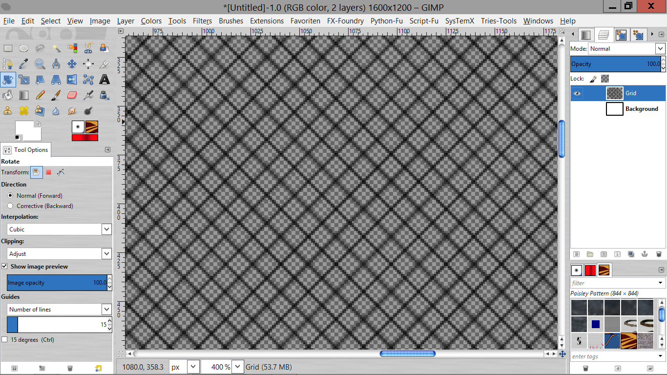

PostPosted: Mon Jul 14, 2014 8:06 am  (#6)
Joined: Dec 08, 2013
Posts: 1088
Thankyou :bigthup
Rotated 45deg :oops:
 Post subject: Re: Grid help please
PostPosted: Mon Jul 14, 2014 8:57 am  (#7)
Posts: 2629
For rotating the grid and getting a good outcome, then a different approach might be required.
Ofnuts plugin path-grid http://sourceforge.net/projects/gimp-pa ... s/scripts/ about 5 down
with the path rotated, then stroked with whatever style you want is a good choice.
PostPosted: Mon Jul 14, 2014 9:14 am  (#8)
Posts: 1088
Thanks Rich2005 :) that was just a throw in. my bad :oops:
PostPosted: Thu Oct 06, 2016 3:57 am  (#9)
Joined: Oct 06, 2016
Posts: 3
Thank you for this help!! I am using this information to create a quilt designing grid for me to use with GIMP. I discovered the problem with simply rotating a copy of the 1st grid layer by 45 degrees. I will try the link that SystemX suggested. This way the diagonal grid will line up with the intersections of the first grid. The diagonal grid needs to be spaced more. (a2 x b2 = c2)
