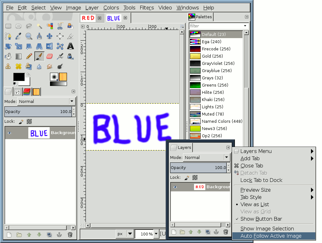

You could also add a second Layers dialog, detach it, disable "Auto follow active image", and (optionally) enable "Select image". This will permit setting your Source (red) image in the detached dialog and, while the Target (blue) image is shown in the main window, dragging from the detached Layers dialog to the Image window (this sounds more difficult than it is).

I didn't know you could un-auto-follow the active image! Heh. That's interesting. Thank you!
It's disappointing that the drag and drop issue is a bug they aren't planning on fixing for a while. I tried both of your suggestions and they do both work, although I'm going to miss being able to drag and drop! I'll get used to it, I guess, or switch back to using multiple windows.
