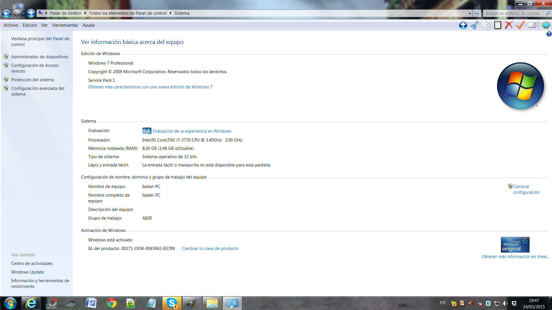

PostPosted: Sat Mar 14, 2015 1:50 pm  (#54)
I think you're correct, jontait2. The question is why the discrepancy between PC's / GIMP installations?
 Post subject: Re: EZ 3D Text
PostPosted: Sat Mar 14, 2015 1:50 pm  (#55)
Posts: 14237
Mi Gimp: 1.6.1.0-beta
PostPosted: Sat Mar 14, 2015 1:54 pm  (#56)
Recheck your version of GIMP, Issabella. Should be under Help/About.
PostPosted: Sat Mar 14, 2015 1:56 pm  (#57)
Posts: 14237
2.8.14
PostPosted: Sat Mar 14, 2015 2:05 pm  (#58)
Joined: Dec 27, 2014
Posts: 508
Right, so it's an Intel i7 based PC running Windows 7 Professional 32-bit and Gimp 2.8.14. Should be no problem.
