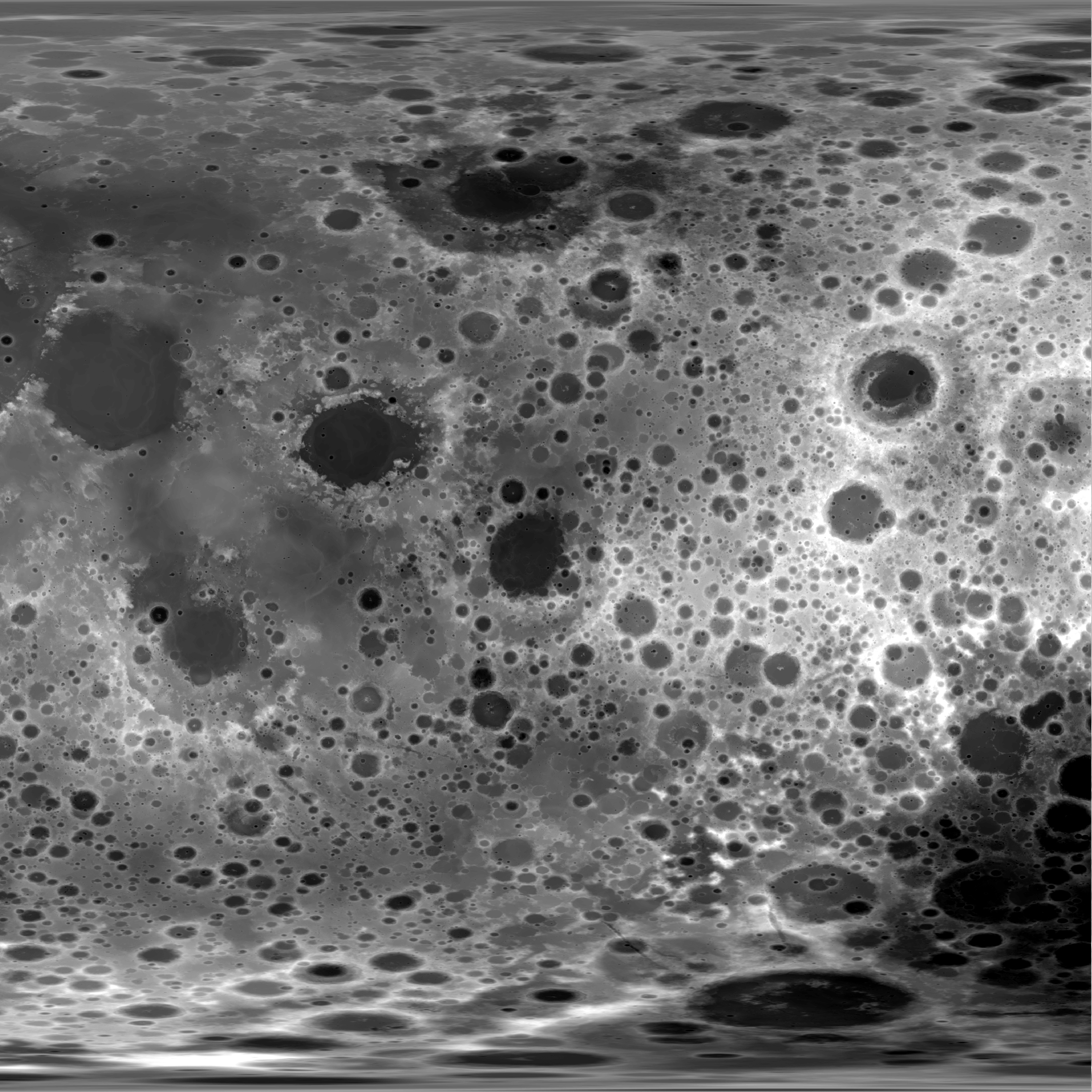

So I'll'mattach a) a square moonar image in cylindrical projection and b) ask you if these Cartesian transformation equations make sense to you:
newx=w/2 - ( cos( asin(( (h/2)-y ) / (h/2)) ) * (w/2-x) )
newy=y
I'm interpreting x,y to be coordinates in the orig. image, and w,h to be width and height of same. I am also expecting both images to have origins at the upper left.
I'llcan give the spreadsheet too if you want to see it.
(Yes, I have put the "Model Railroad Coffee Tables" on hold for the nonce...)
Best greetings, friends!
gramp
P.S. found the map at:
http://astrogeology.usgs.gov/search/det ... ar2014/cub

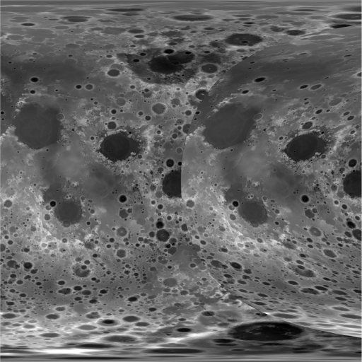

...and, quelle surprise!, my gut is "at least half" right.
Take a look at this modified form of the X-warping function (Y-warping remains 'y'):
X-warping: cos(asin( ( (h/2)-y ) / (h/2) )) * x - w/2
The most bizarre behavior to me is this: I expect the "-w/2" term, a constant, to be a shift of "w/2" pixels (half the width) to the left, but it definitely affects the curvature even as it's effecting a shift.
Note that the transformed file layer lies over the original rectangular depiction, and also note how features are "bent" in the output.

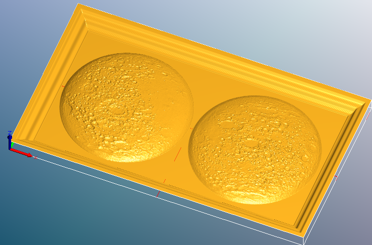

I'm gonna cut this out and hang it on somebody's wall somewhere.

...not just a look anymore! :mrgreen: (That's what I meant by "cut this out".)
