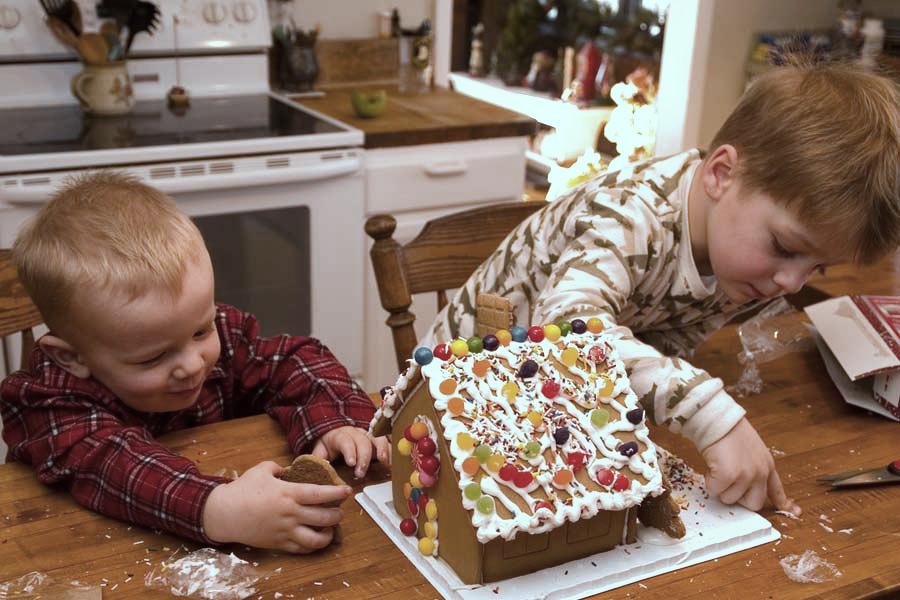

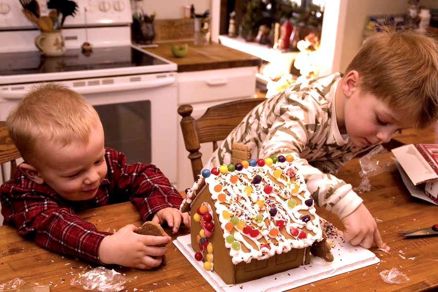

I found an awesome tutorial on fixing color cast in photos at gimp.pixtuts.com I searched the web for pics to use, and found a good one used in a photoshop tut. I tried it in GIMP, following the Photoshop instructions, which were quite different, and I couldn't complete it. I then followed the GIMP tut, and I was quite excited about the conclusion.
GIMP Tut: http://gimp.pixtuts.com/gimp-tutorials/ ... correction
Results below:

Nice outcome steven8.

I like it, but the colors seem a little muted. Not enough saturation. Made me want to try this G'MIC HSL adjustment, though. I just used it. with tweaks, and I prefer the result over my original repair. What do you think?
I tried calibrating my monitor once. I have no idea if it did anything. :)

Anything that doesn't make the stove pure gray isn't really working correctly. Iarga's results are the closest...
This script does just that...
