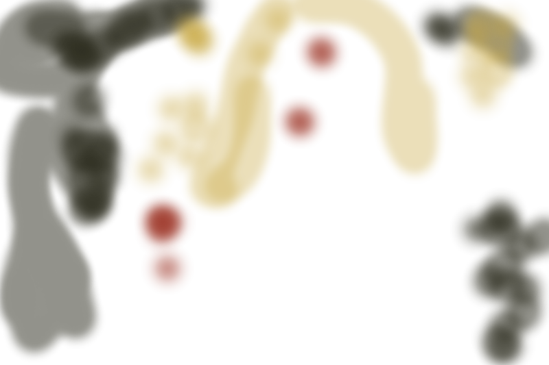

layer with some colours paints (dodge)

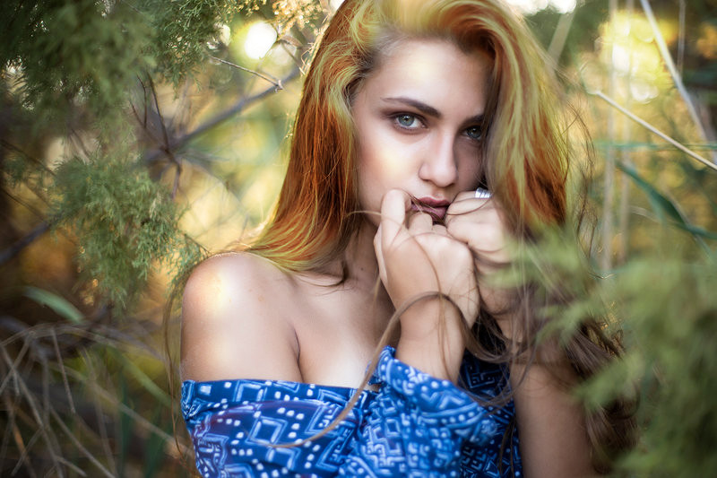

outcome
