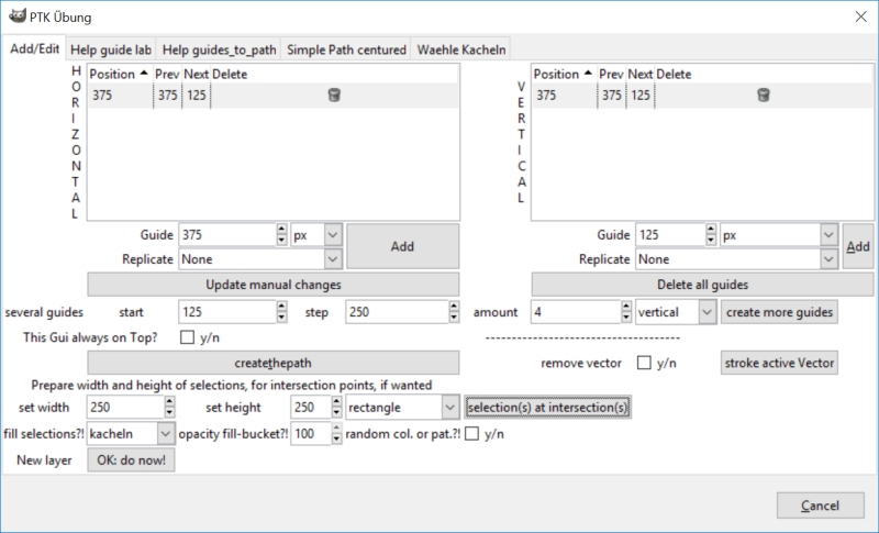

here the UI for my adjusted guidelab:

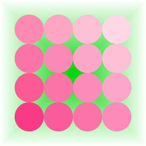

and here an example of use to build a GIF

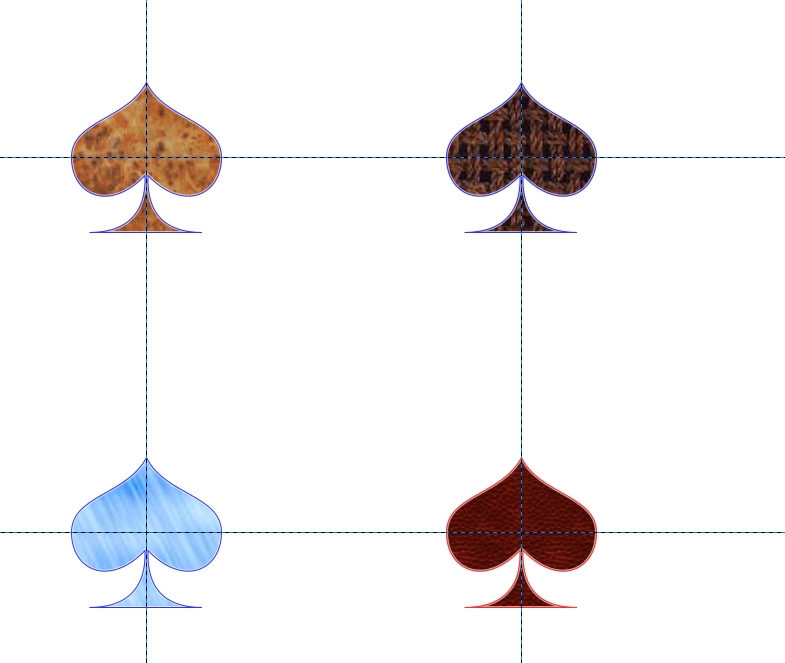

Now an example WITH the use of the Simple path plugin used:
or this :yes

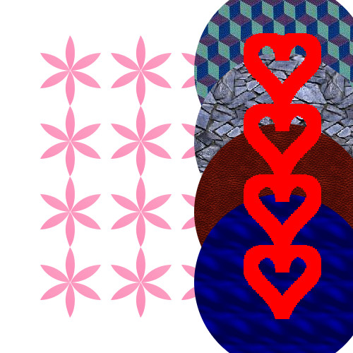

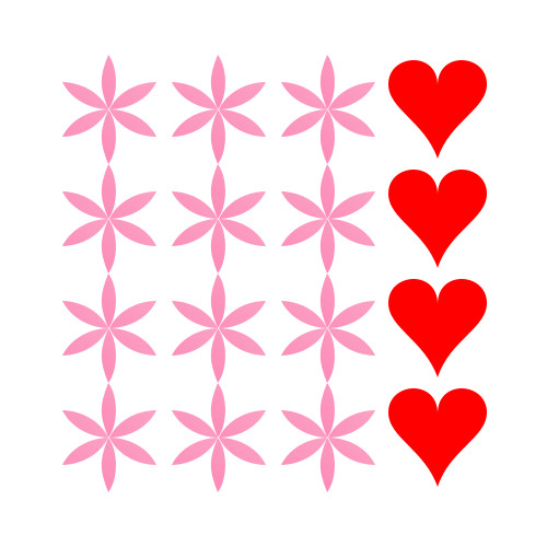

Works now:
At this moment the switch to select random patterns is on the Add/Edit tab, should probably got to the 4th tab too (or a message there)
