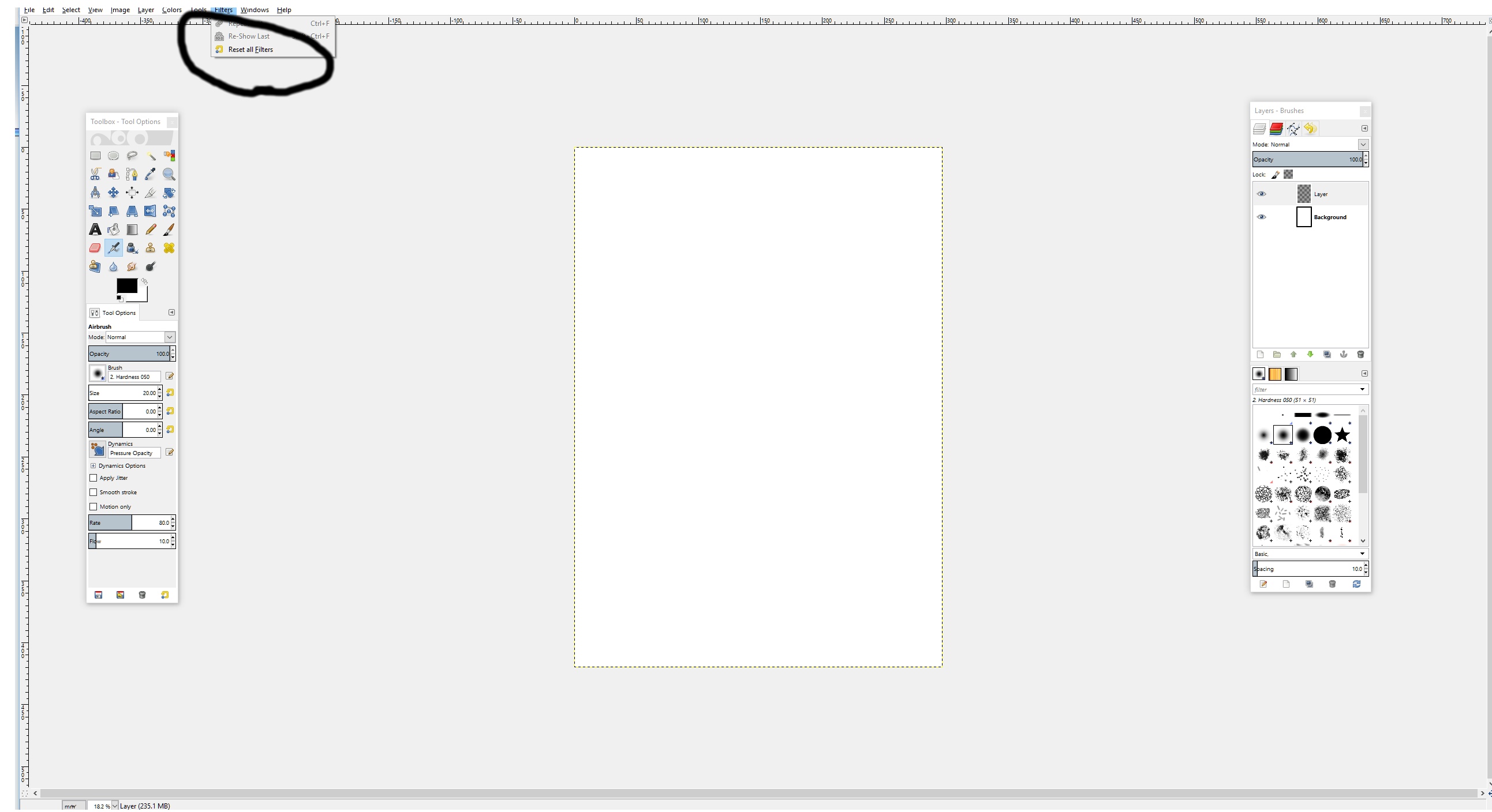

ok long time photoshop user complete gimp noob. so I am a 3d artist and I wanted to make normals and other maps in gimp. I downloaded the plugin for normals then put it in properly and now my filters dropdown doesn't show anything except to reset filters. what am I doing wrong? also, how do you save things in jpg or png?

You are missing all the default filters for sure. Not sure where you downloaded your version of GIMP.

That's very curious looking.
I've never seen this before.
As lylejk has mentioned,
Where did you download Gimp and what version?
Also,
this could be a User Profile issue.
Most of the time,
if you create a new Gimp User Profile.
This can correct many issues within Gimp's interface.

...I downloaded the plugin for normals then put it in properly...
I think a pertinent question is, exactly what did you do here? What is properly?
Best guess, deleted or changed the reference path to the system plugins folder in Edit -> Preferences -> Folders -> Plug-ins.
The fix, click the reset button.
...how do you save things in jpg or png?..
You only Save in Gimp native format .xcf etc Everything else you Export

thanks for all the advice guys! rich you were right i had to reset my plugins path thanks so much!
