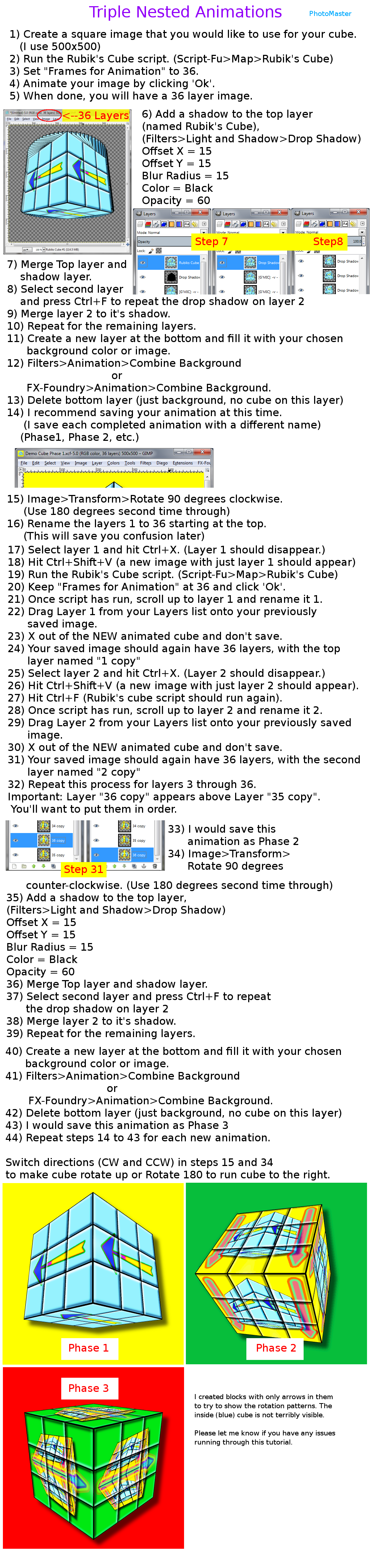

Here I have an animated green cube, inside an animated blue cube inside of an animated pink cube. This is a Triple Nested Animation. My apologies in advance, because some of the tutorial repetition makes doing this tutorial a bit lengthy. I can get the entire thing done in under an hour. Your time may vary!
EDIT: I modified the tutorial with minor rewording and pictures, to hopefully make the tutorial easier to follow.
I will work on a script to animate the process. My script writing skills have been dormant, so it will take a while.

PhotoMaster: I worked long and hard on this tut but I still have some glitches. I don't know where as I could not find them. I will attempt this again, but not for a few days. I may have some questions for you before I start. Anyway, here is what I was able to do.

Does anyone know why I get these error messages ? I'm running GIMP 2.8.20 with Windows.
I decided to try out the tutorial but only got as far as step 3 (well, 4 really)..
I run the Rubik's Cube script, set "Frames for Animation" to 36 and... it does the following (see pic.) .. basically just repeats the layer and stops, I've tried it with a flat colour surface too, get the same errors.. Thanks for help.

Pat,
Great work!
On frame #23*, (#14 from bottom) an extra shadow layer got merged on top of the cube. I've done that quite a few times myself. If you still have a copy of the 2nd (Red) animation, just re-run the Rubiks script on layer #23*, (#14 from bottom) , add the shadow and background to it and use that single image to replace the layer with the shadow error.
On frame #17* (#20 from the bottom) it looks like you pulled frame #21* (#16 from bottom) from the intermediate animation created in steps 27 and 28. Just re-run the Rubiks script on layer #17*, (#20 from bottom) , add the shadow and background to it and use that single image to replace the mismatched layer .
By pulling those two layers, the animation works fine. It will be smoother if you replace the 2 layers I deleted.
Your cube is excellent!
* Because the animations run from the bottom to the top, when I loaded your gif the layer numbers were different.

PostPosted: Wed Mar 29, 2017 2:38 pm  (#11)
I only have the file that I posted as you instructed to delete the others as used so I may not be able to fix it. Also, I wondered that I started on the correct "top layer" as when doing the repititions, there would always be listed Rubik's cube at top, then a G'mic layer without the numbers after it, and then a layer with #1 after it. Was I supposed to start with the very top layer, or the one numbered #1. I started with the very top one each time.
Also, in the instructions, when you state to repeat 14-40 for each new animation, do you mean to repeat #15 again to change direction? It had just been changed in #32. I got confused as to what I should change #15 to as it had already been changed to clockwise and counterclockwise. I think I chose 180 degrees. Was that correct?

Sorry for any confusion. You did select the correct layer "Rubik's Cube". You are right, the second time through steps 15 and 32 should be 180 degrees. In step 14 I mention saving the animations. I should elaborate that I save each of the three animations with with the names Phase 1, Phase 2 and Phase 3. I will go and fix these in the tutorial.

Updated the tutorial with clearer wording and some pictures. Please feel free to ask me any questions you might have.
