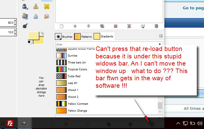

PostPosted: Sun Sep 03, 2017 9:05 am  (#13)
Joined: Aug 28, 2017
Posts: 10
Do you have a solution to this ?
 Post subject: Re: Changing Text on an Image
PostPosted: Sun Sep 03, 2017 9:14 am  (#14)
Posts: 10
OK - I managed to detach the gradient box and press that update button ... but alas the Button gradient wasn't added.
And I had restarted Gimp after putting the files into the folders.
PostPosted: Sun Sep 03, 2017 9:16 am  (#15)
Just in case it can be useful in a similar case: move the bar to the right (there is an option for placing the windows app bar at top, bottom, right, left side; right click on the bar and choose setting)
PostPosted: Sun Sep 03, 2017 9:26 am  (#16)
Posts: 10
Thank you so much
Done it :)
